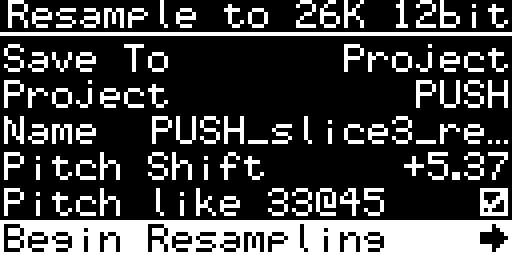

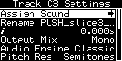

The context is as follows. Created 8 mutislices on pad B1->P8. I want to create the 12 bit version of theses samples on pad C1->C8. But doing the resampling process seems to create nothing with 0.000s as information. I can’t find corresponding samples in “Browse Files”. I can send the project in private if necessary.
Seems to be an issue when using the same sample on 2 tracks. I’ve tried to rename before or save before but without success.

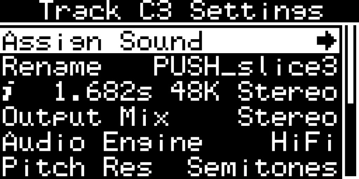

Anyway to try to overcome these limitations, I tried to create multislices then copy these multislices. So to answer your question I create everything on A4, then exctracted slices manually and assigned samples to B1-B8. After adjustment on B1-B8, put these slices on C1-C8 to create the equivalent 12 bit version but could not resample at this point. It created nothing or something empty I don’t know.
