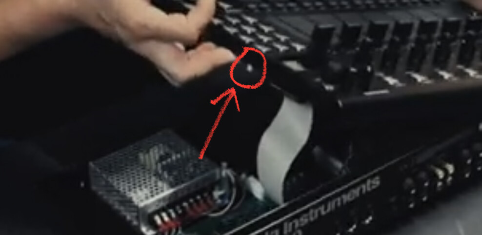

The install itself is easy peasy. The only thing to watch out for is a capacitor on the right outer edge on the print side of the top panel.. when I opened up the unit I accidentally grabbed it there and one leg snapped so I had to re-solder it to the print.
just a warning to watch out where you grab that top print, since you now know and will be mindful of this there is nothing to worry about.
