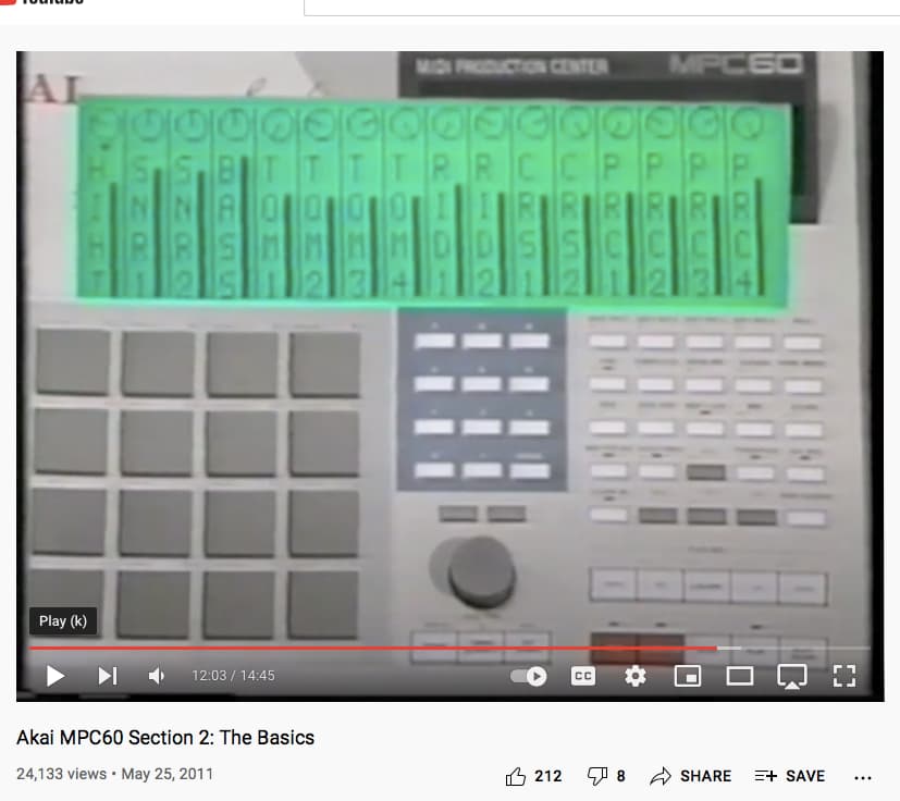

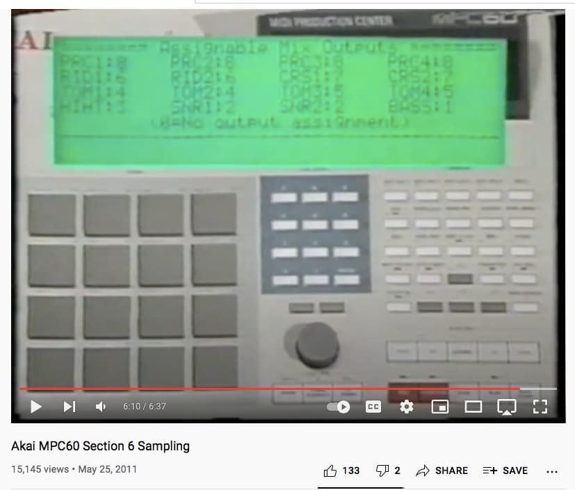

Here is how it’s done on the MPC60 (16 voice).
Dunno how it is on the MPC3000 (never had a 3k before)… but it might be the same by just hitting ā€˜Bank 2’ button, irdk.
First pic shows ā€˜Assign Outs’ - Assigning track/sample/pad to one of the chosen 8 hardware outputs.
Second pic shows ā€˜Drum Mix’ - Which gives you an internal-mixer (for levels and pan) that outputs through the stereo-mix/bus hardware outs.
Additionally, a simple & easy press of the ā€˜Bank 2’ button, quickly transforms those ā€˜Assign Outs’ and ā€˜Drum Mix’ pages to show pads/samples 17-32.
(even though the mpc60 was only 16voice, you could still load 17-32samples/pads on ā€˜Bank 2’ …so, this approach would also work with 32voice)
