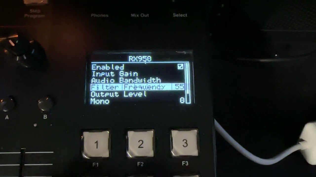

RX 950 plugin
It’s fine.

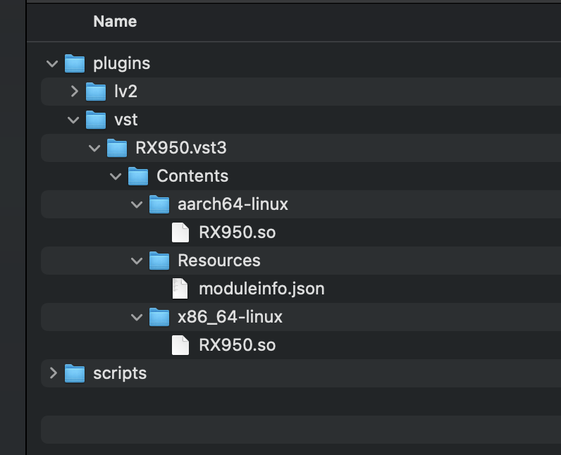

Make sure you are copying the VST3 version of the plugin, not the VST.
For clarity, this is exactly what the folder structure should look like on your SD card.
You can probably just delete the x86_64-linux folder since it wouldn’t be used.
