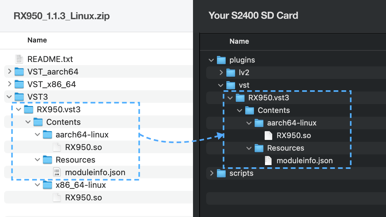

The latest Linux version of our RX950 contains the working Aarch64 build.
Here’s what to copy from the RX950 Linux zip archive to the S2400 SD Card:

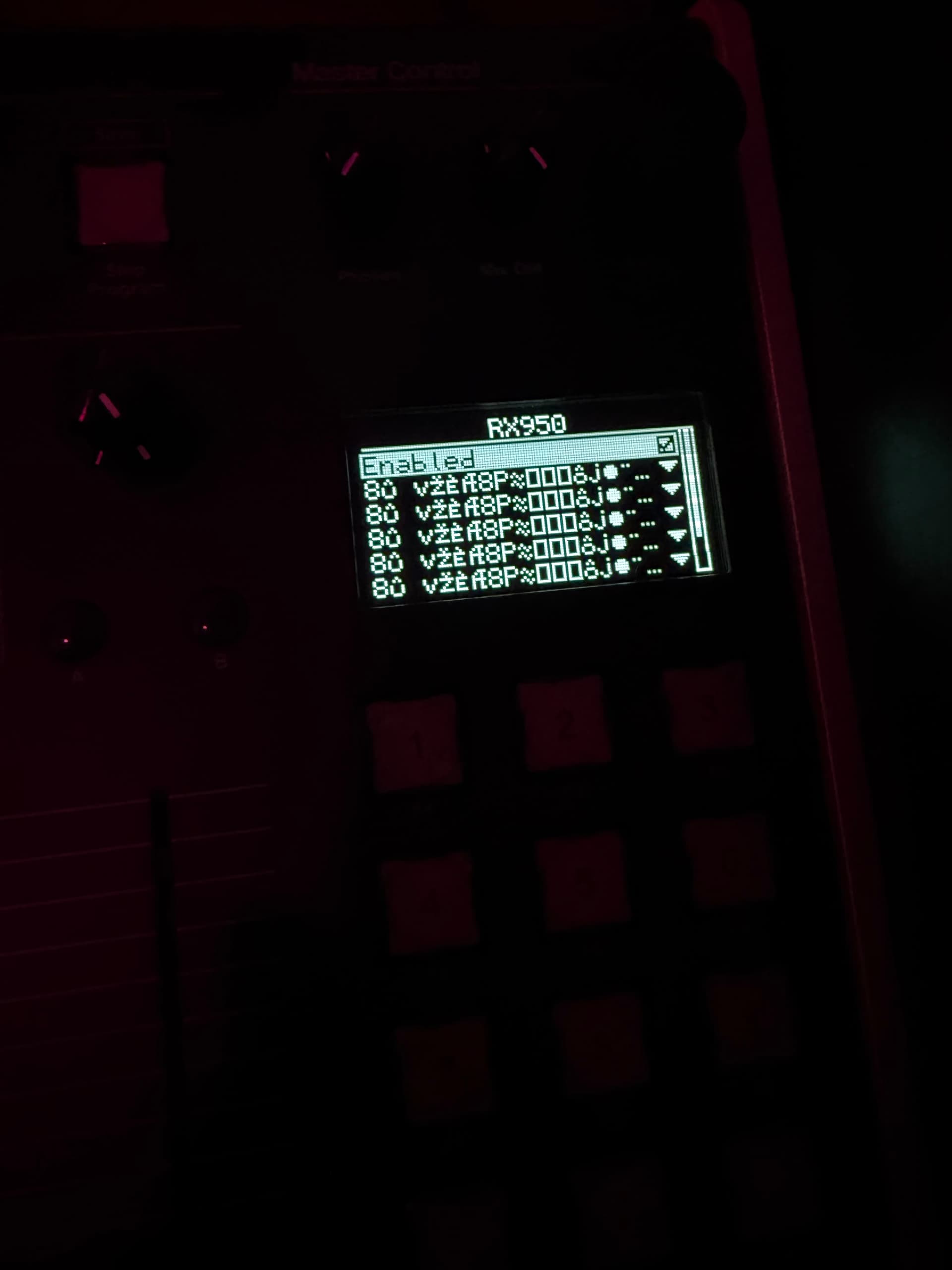

Its stopped working now on the latest formware rleasead today.
Just getting this when I load it
urrgh. confirmed… investigating.
Hi,
Mathieu says he found the cause of the bug.
The crash would occur when two parameters are changed simultaneously.
I’ll let you know when a fixed build is available.

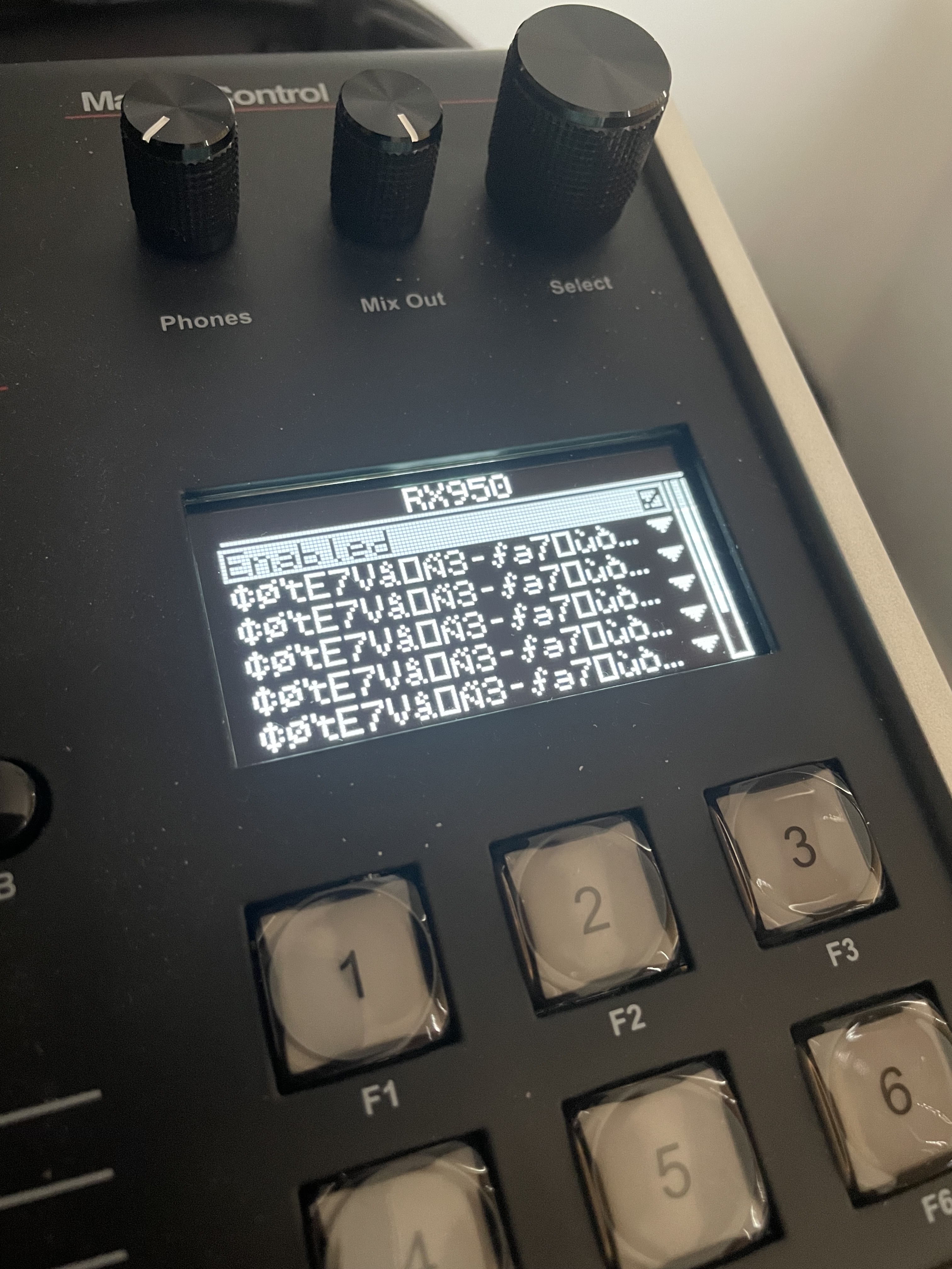

Happened on my machine after the update as well, and now my DSP card won’t initialize. Not sure if it’s related but the update went fine until I loaded this plugin. Is there a way to reinstall the firmware? Sorry maybe I need a diff thread for this .
Same same
Yea, I’ve got the same issue here. RX950 plugin installed. worked great with previous firmware, now see pic.
installed: s2400dsp-3.1.7.swu / S2400_20250317.upd
Hoping for a fix soon =)
bug has been found, will be in next release
