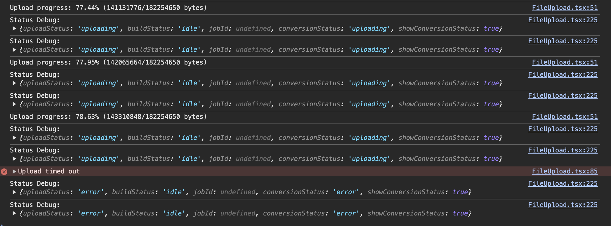

If you bring up the developer console in chrome, Control + Shift + J on Windows and Command + Option + J on Mac.
You should see the file upload in chunks, let me know what percentage it gets to with one of the files that craps out.

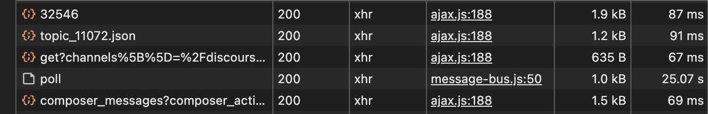

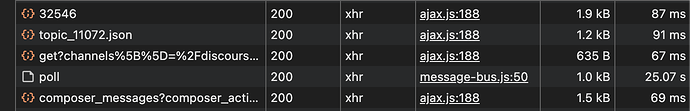

Did the j-key command, and these numbers don’t say “screaming fast” to me.
you’re looking at the wrong thing there in the developer tools, you should be looking at ‘console’ tab.
do it before or as it is uploading.

so you’re crapping out at about 75% or so I see. about how long does it take to get to that point before it craps out?
two things are at stake here. file size upload limit (you’re not hitting that) but also time to completion, and it looks like that’s the issue there.
I’d estimate 60 seconds?
