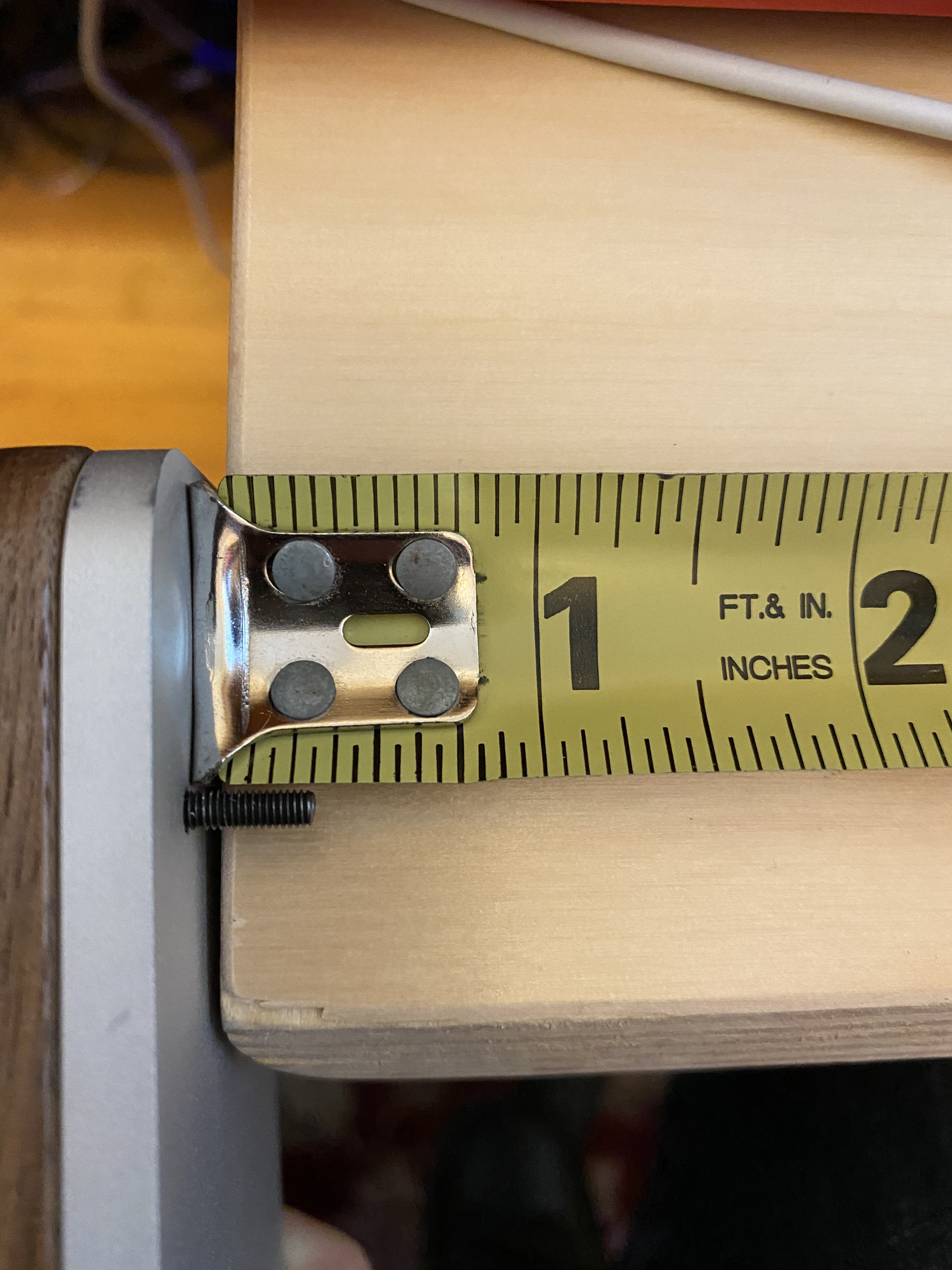

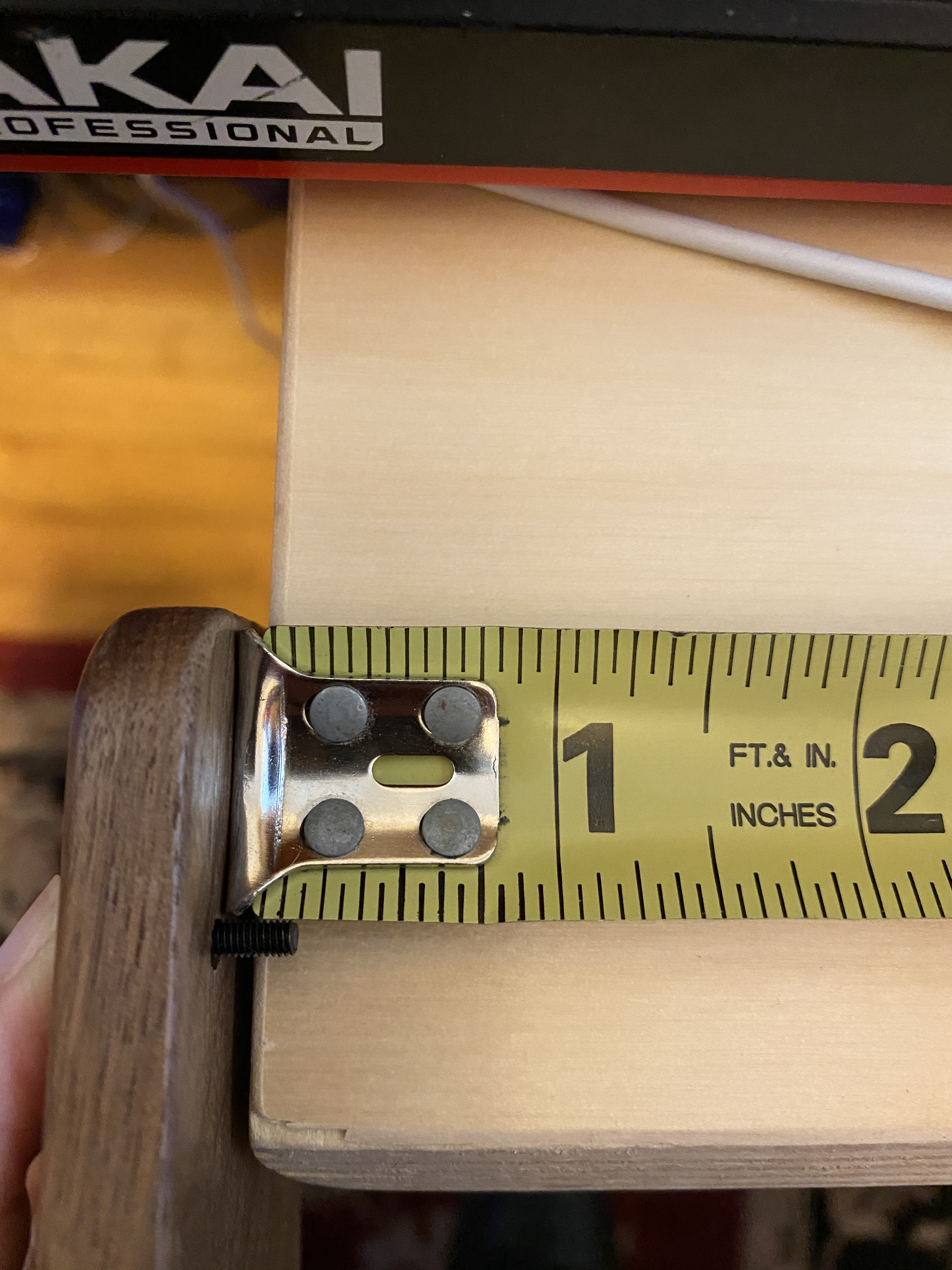

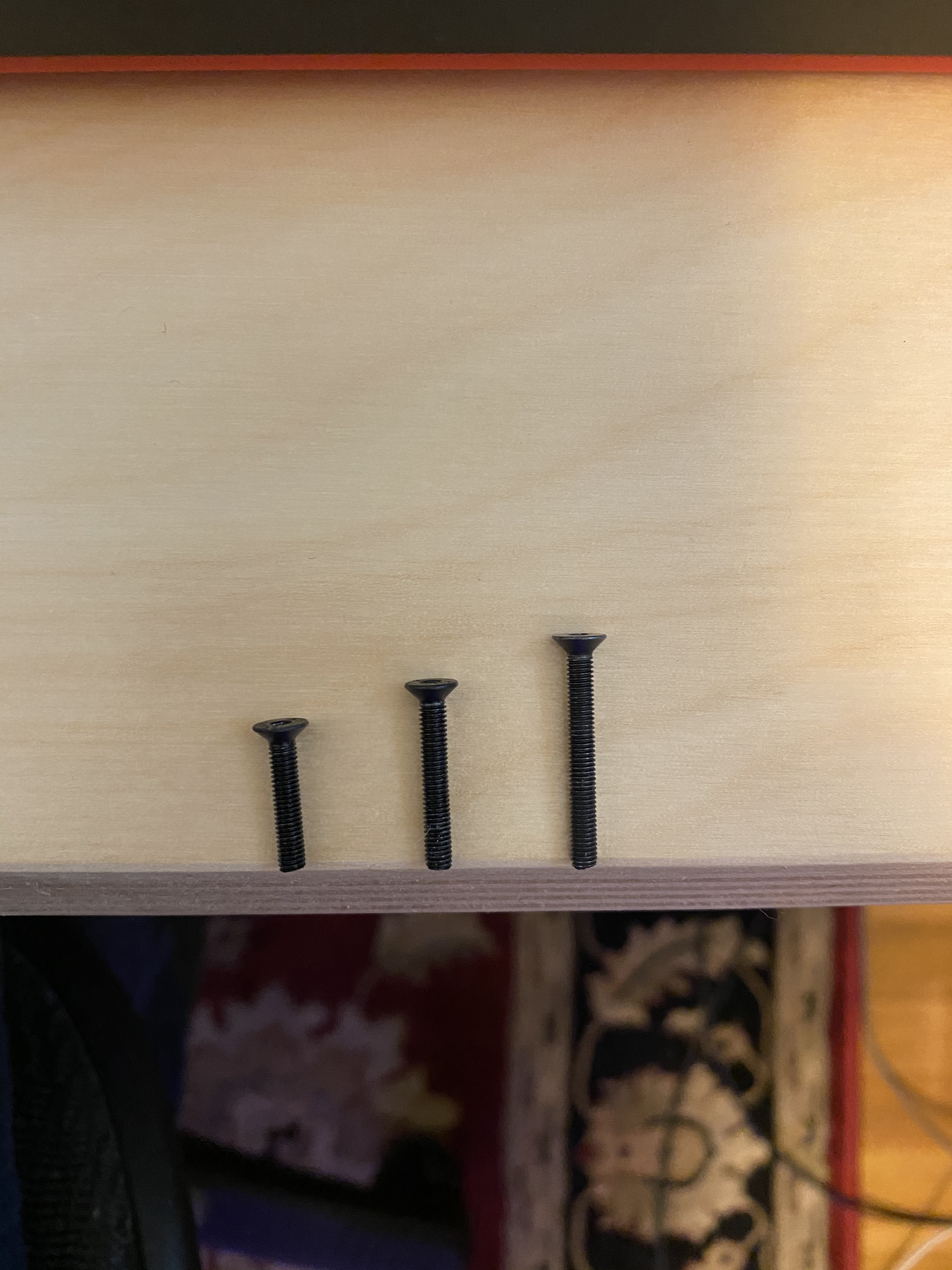

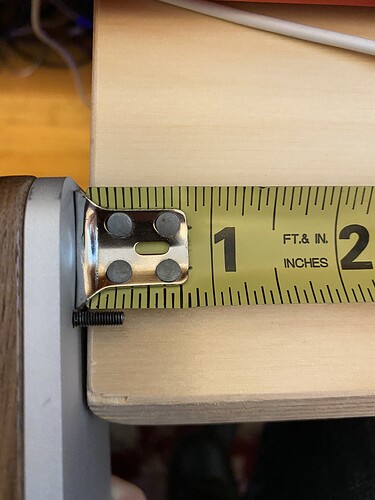

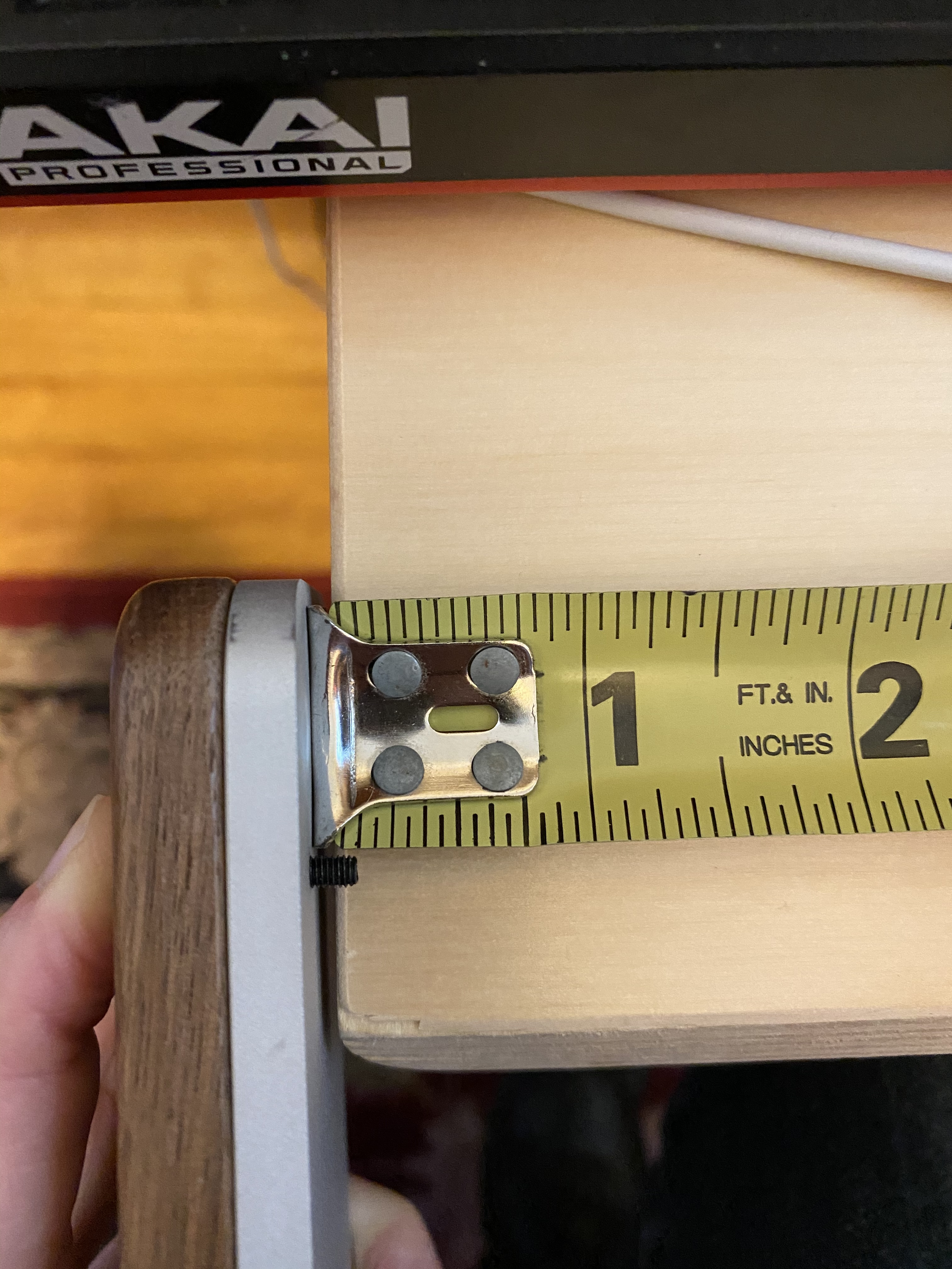

Okay the screws came in and I did some measurements. The screws that come with the wood sides are 16mm. The next set of pictures shows what is left between the 16mm with wood only vs the 20mm or 25mm. The difference between the wood only and 20mm is 1/16th of an inch vs the additional 2/16ths on top of the 16mm.

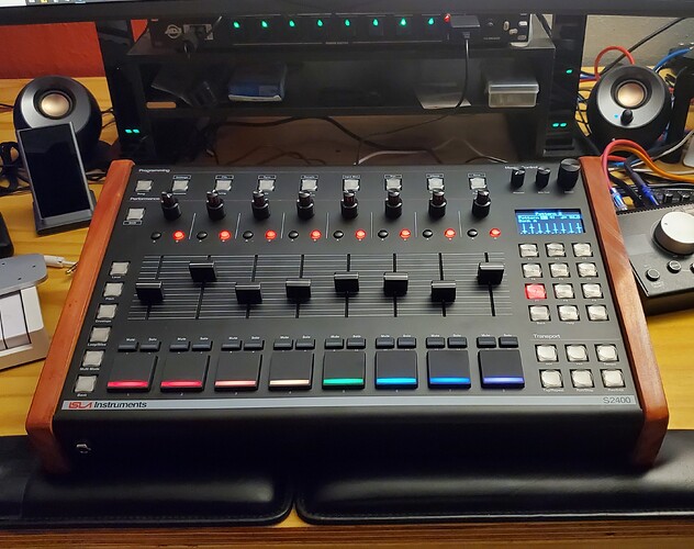

I’ve used the 20mm on the entire right side of the s2400 and it is solidly connected to the chassis. It would be my recommendation to go with the 20mm over the 25mm for any future adopters of combined sidings just to avoid the potential of having issue I did.
16mm
20mm
25mm

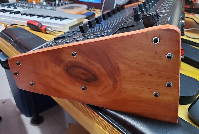

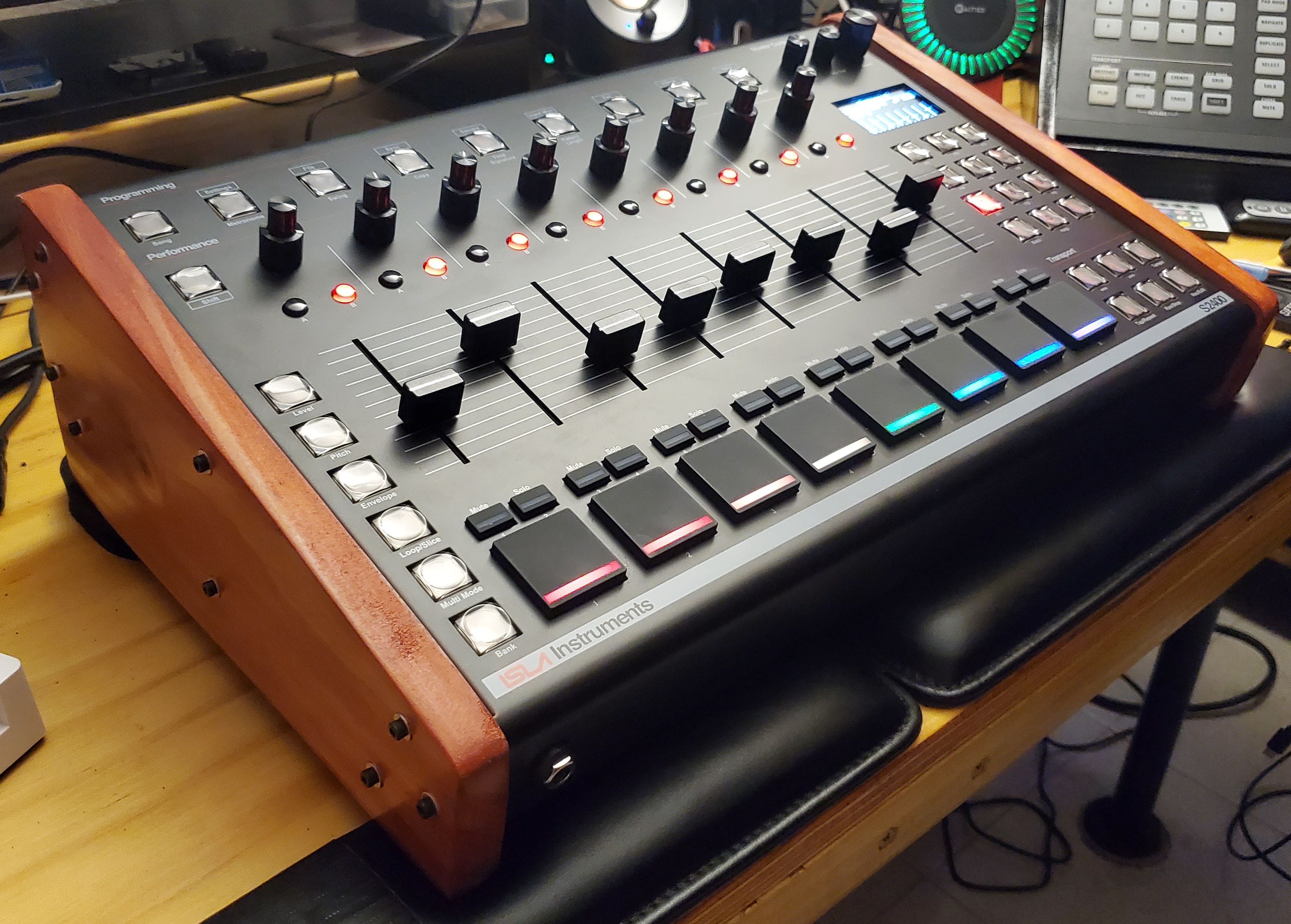

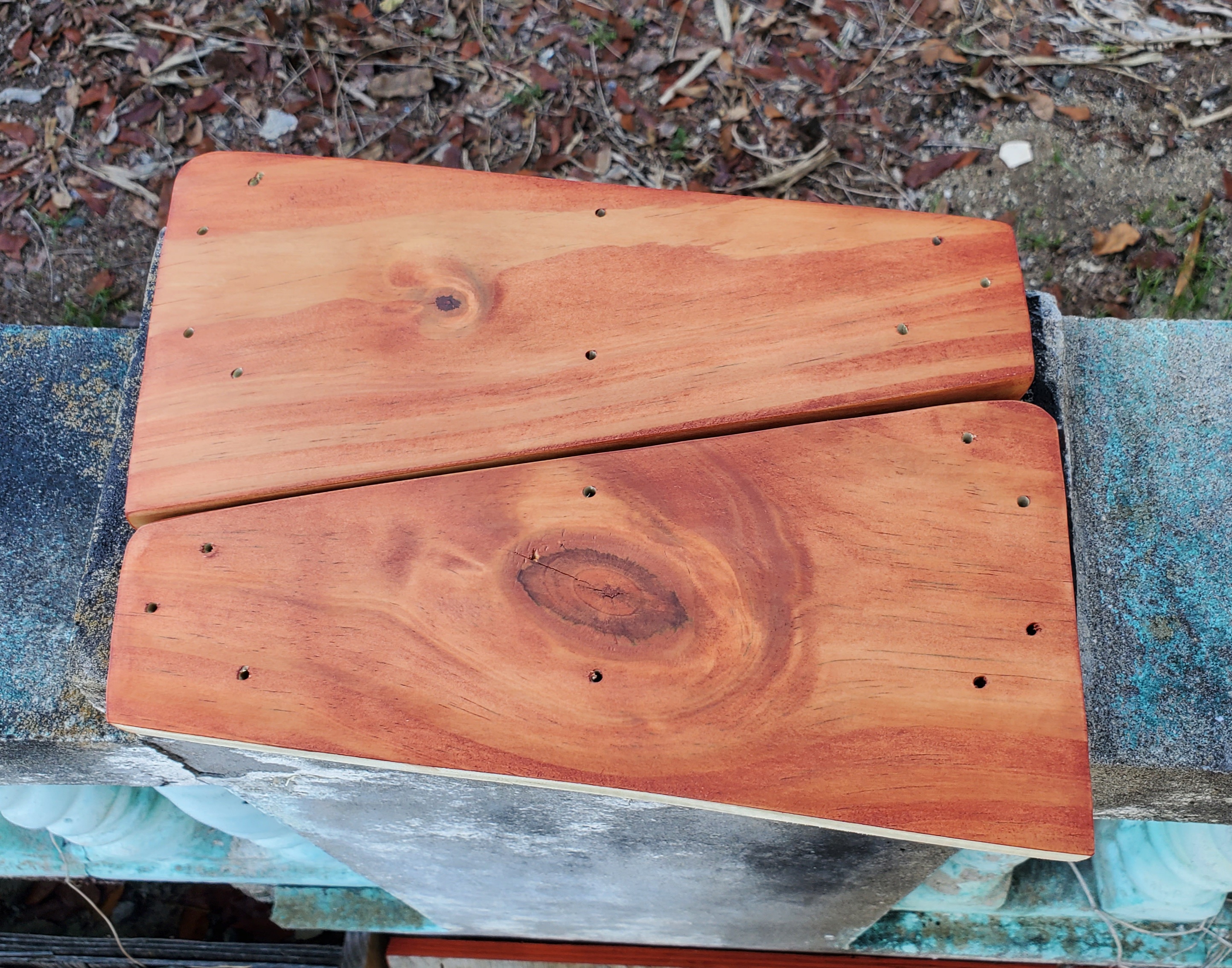

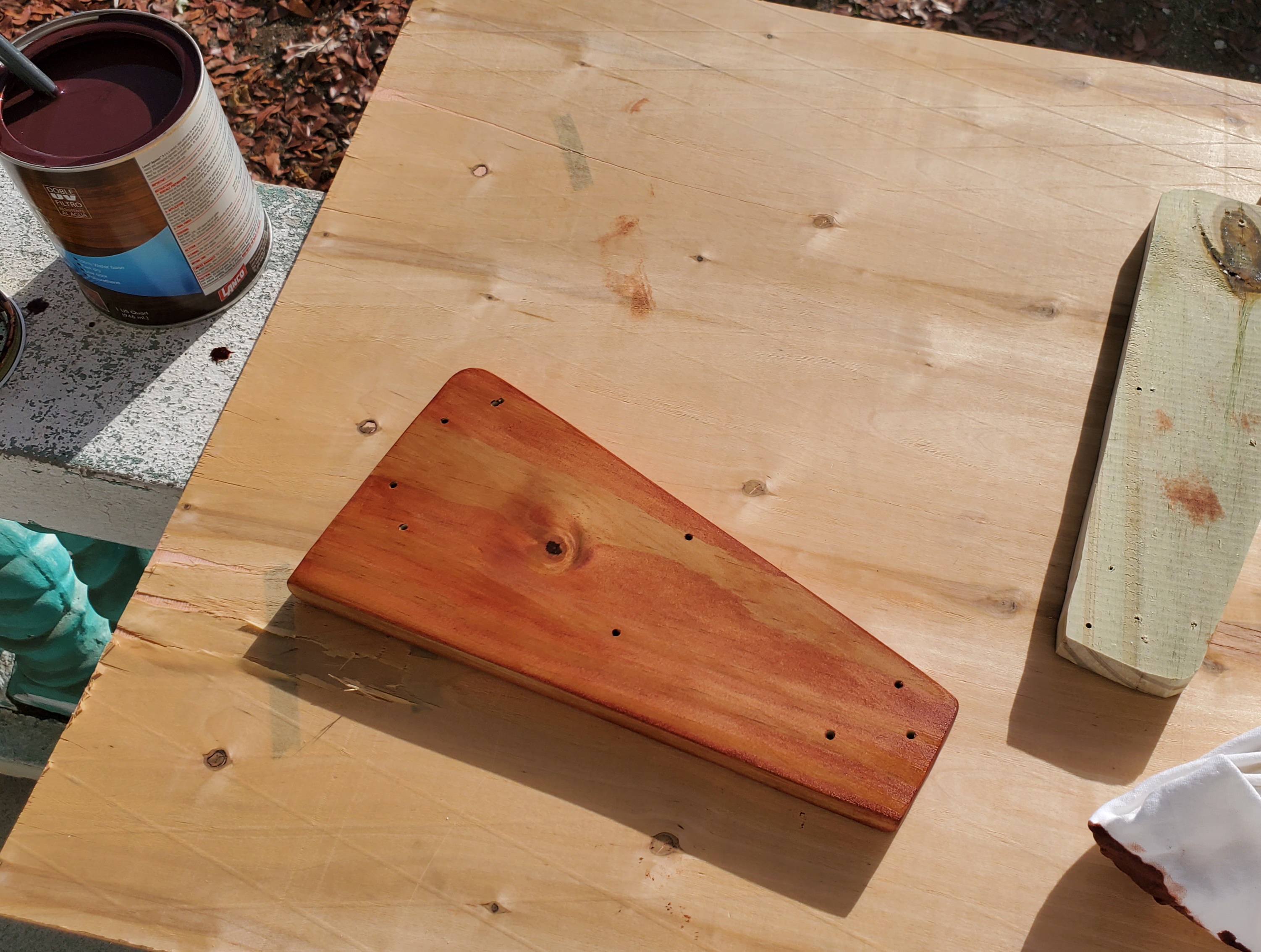

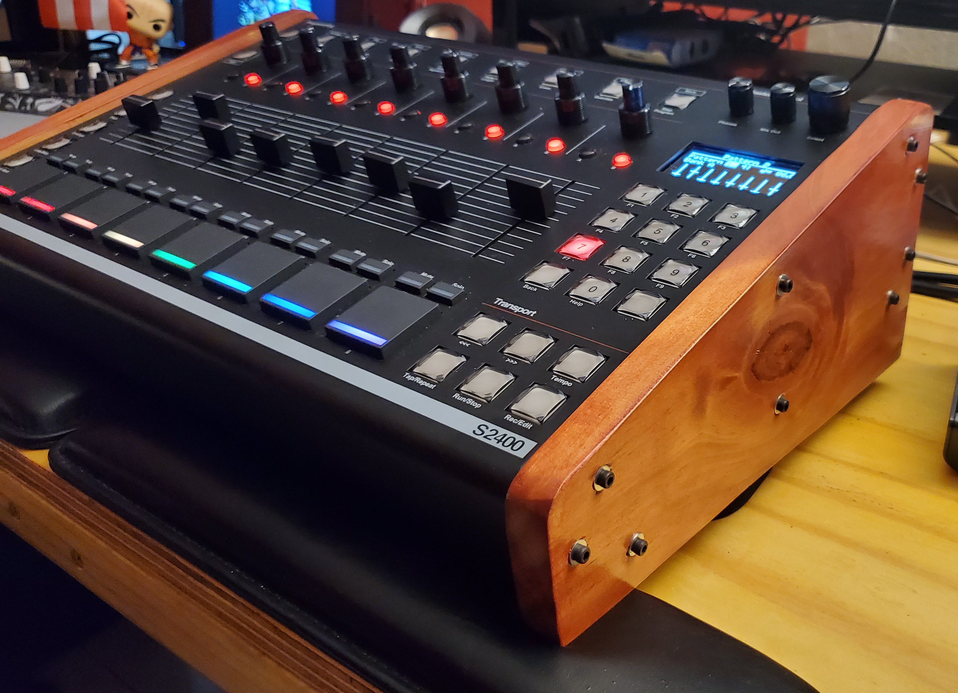

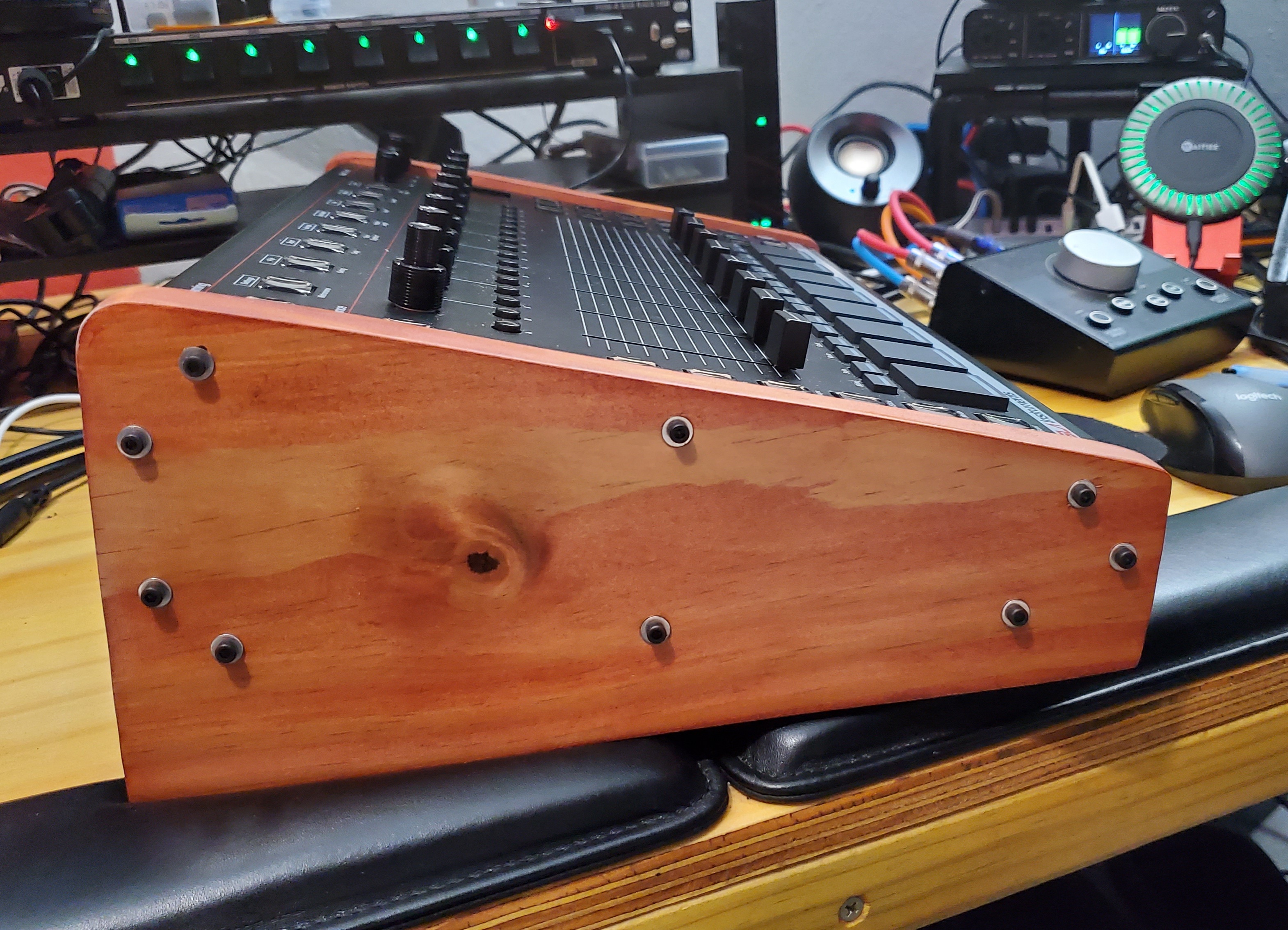

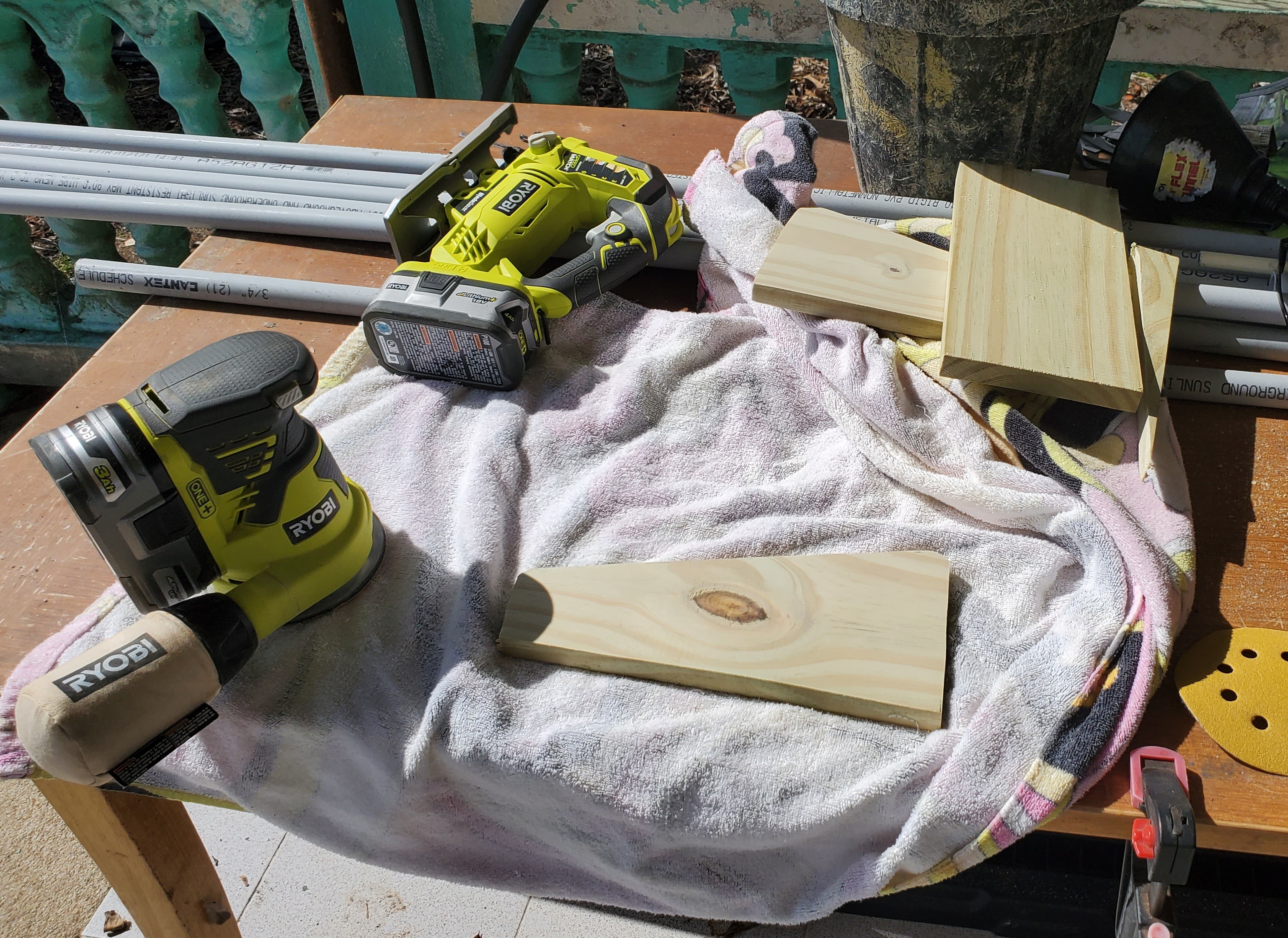

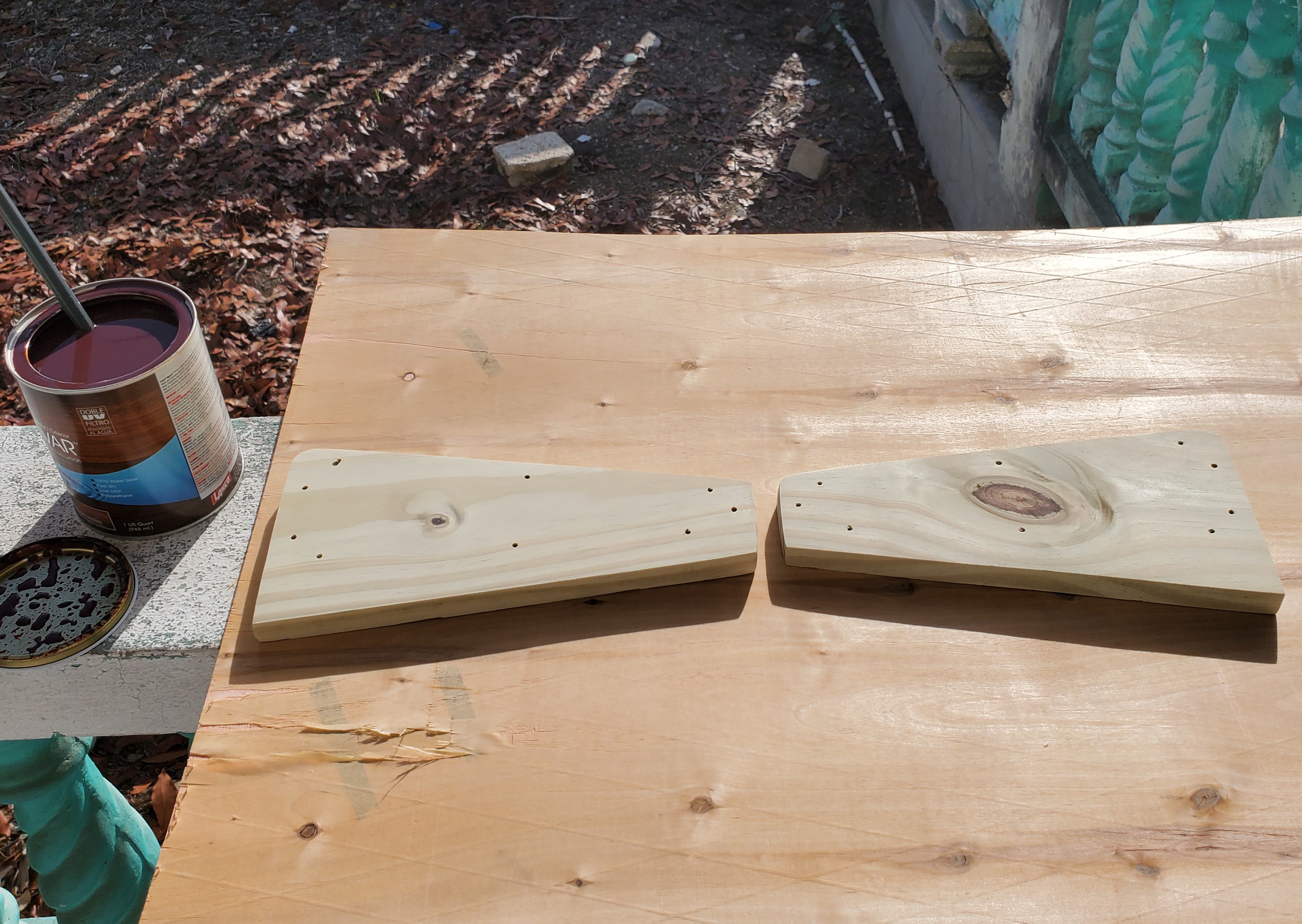

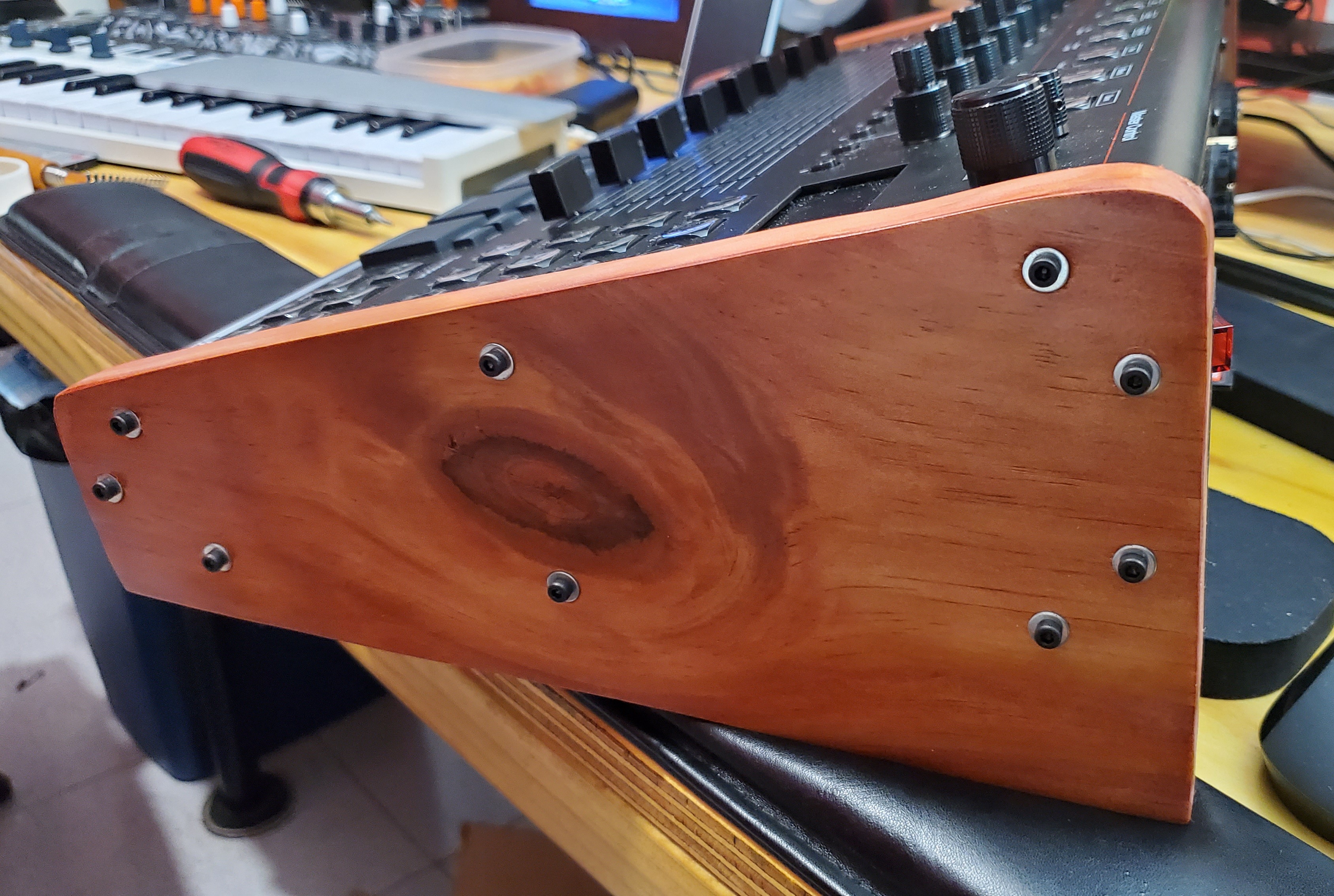

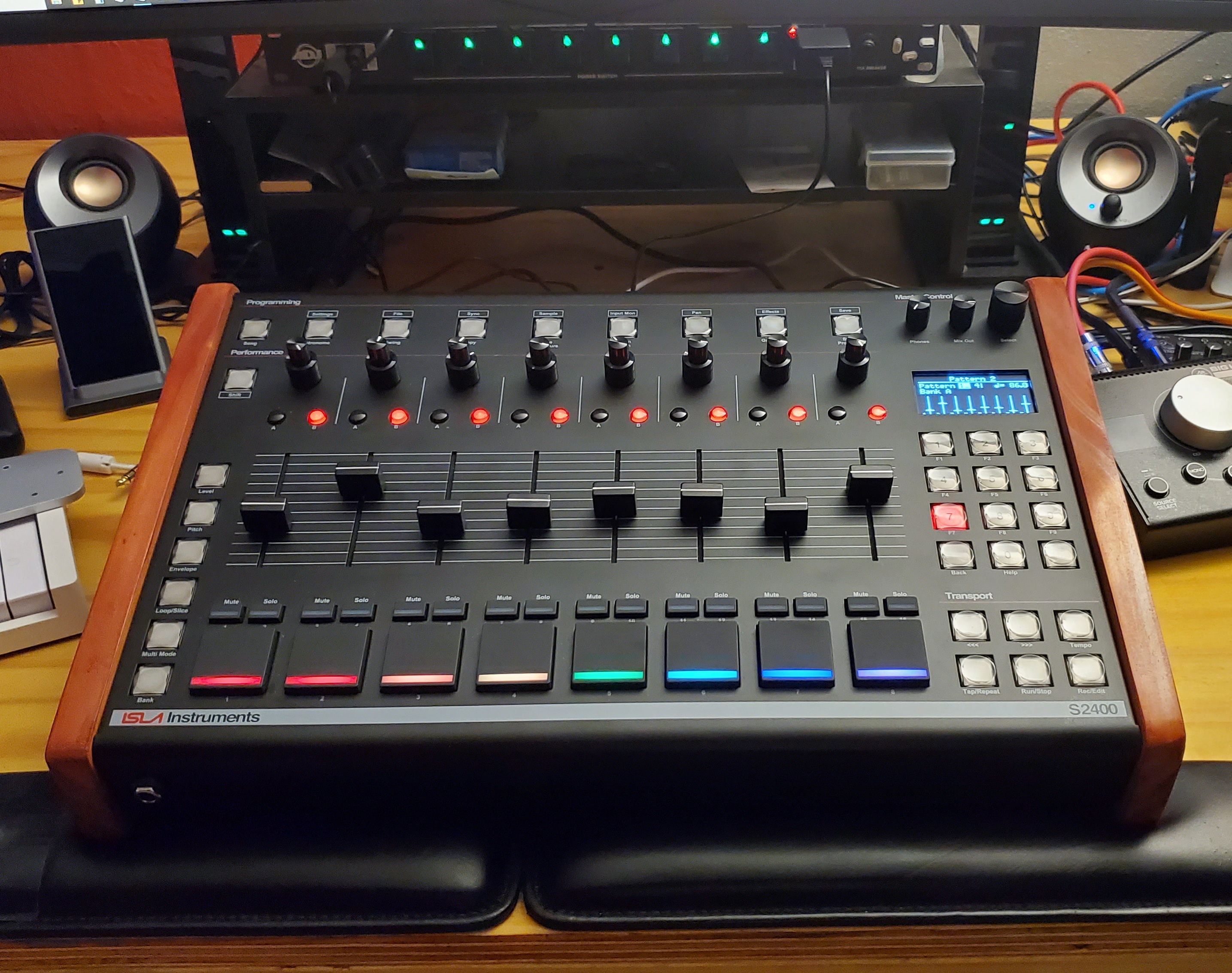

Custom wood panels by yours truly.
3/4" by 6" pine wood (treated)
All in one primer/stain/varnish (2 coats)
FullerKreg M3-0.5 x 25mm Black Oxide screws from Amazon
Stainless steel washers

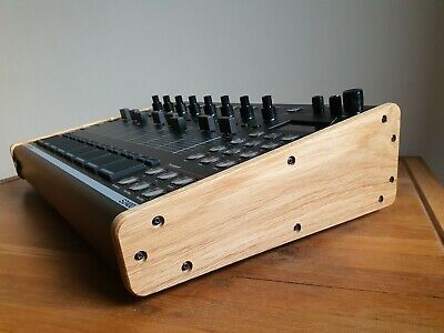

I got some off ebay in the UK. They have oak and also black valchromat. No waiting and fast delivery.
