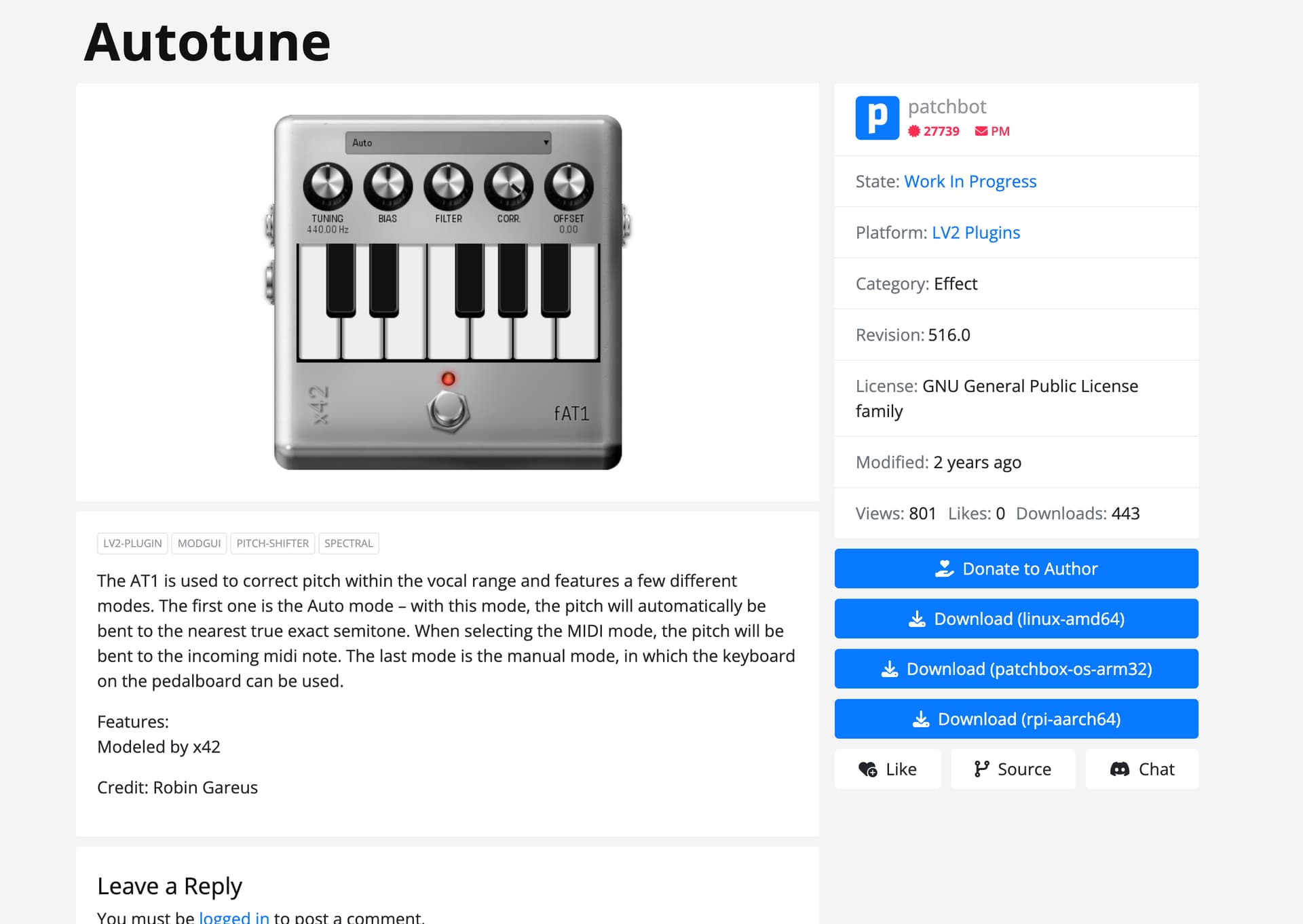

I suggest that you post screenshots of your folder structure here, so I can see.
further. exactly which one did you download, which blue button did you click?
this one does not work as it needs the fftw lib which we dont bundle
