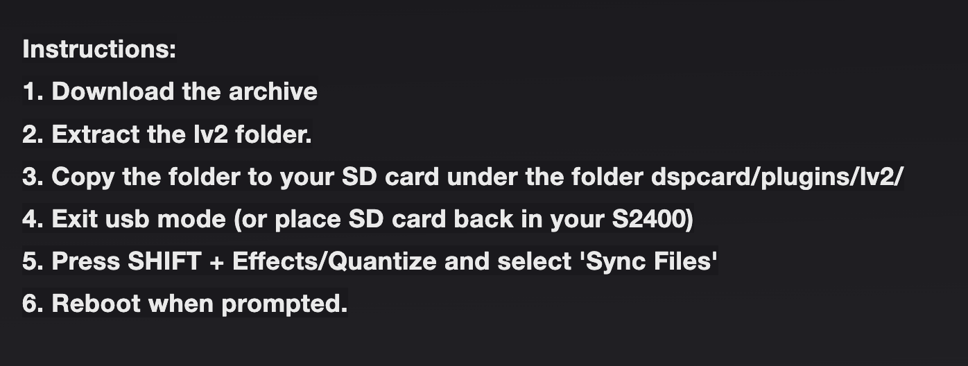

The plugin installation procedure isn’t working — after syncing files and rebooting S2400, I still can’t see the plugins. Why is that?
If you mean all plug-ins in general, I’ll suggest you make a new topic about it and describe the procedure you use.
No, I only want to add one specific plugin from the ISLA website.
Okay, so nothing wrong in the procedure.
I think I remember Brad mentioning in a video, that doing step 5 (sync files) twice can be a good idea. The machine could somehow occasionally miss it the first time.
I had some problems with the Calf plugins not showing up. All of a sudden they where there after some attempts.
Maybe worth a trying again.
Or tell which specific plugin you mean. Maybe someone else in here can tell if they’ve had the same problem.
