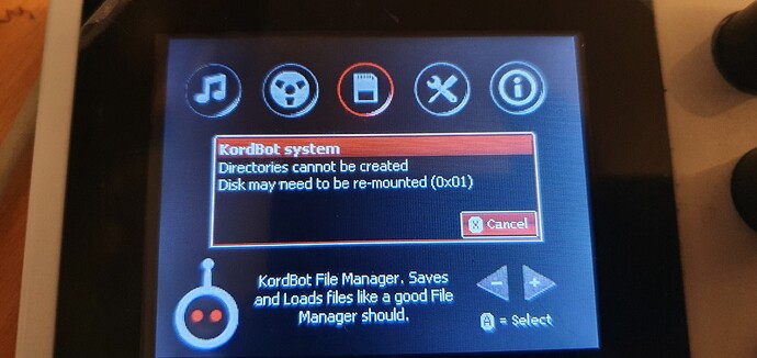

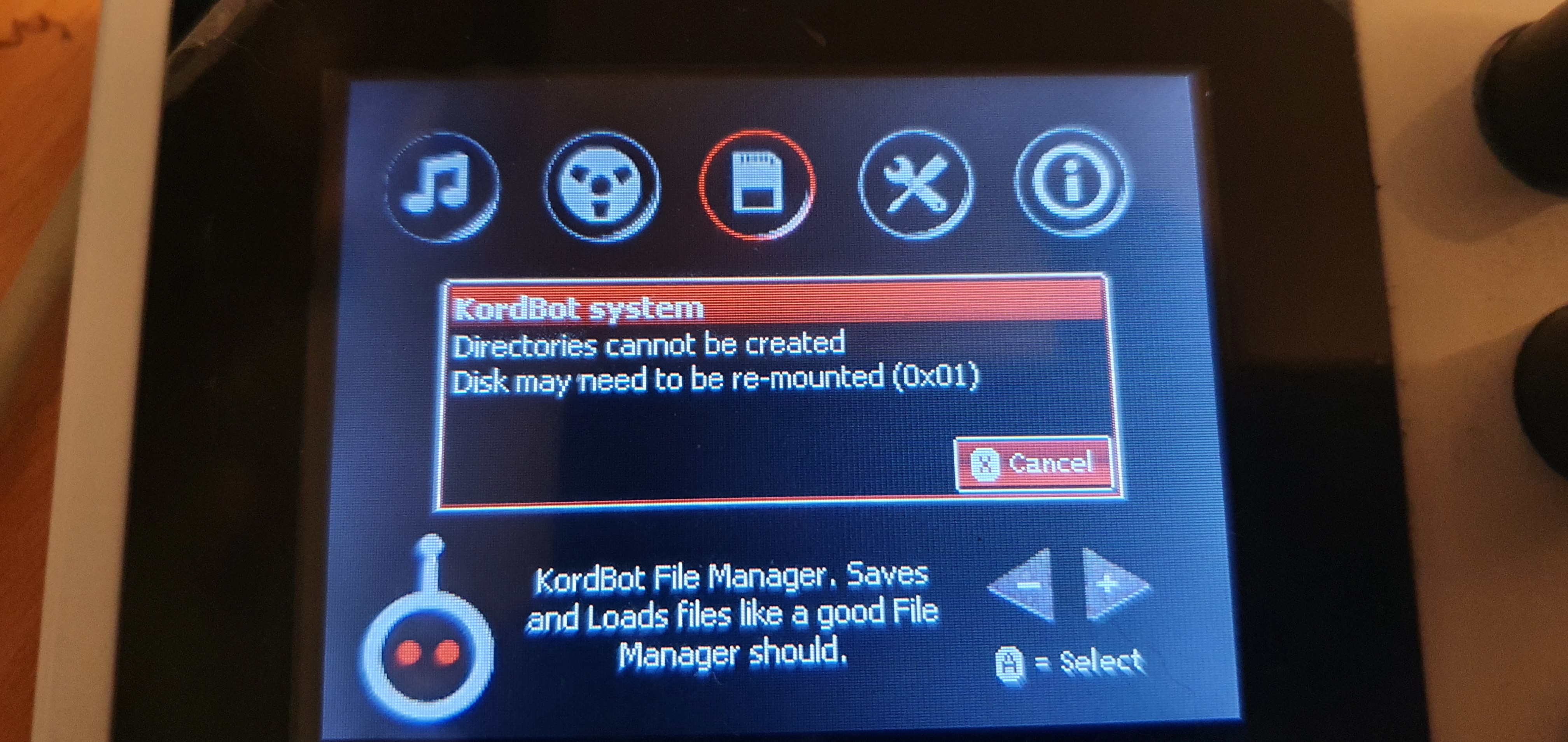

did you create system files? using the menu option

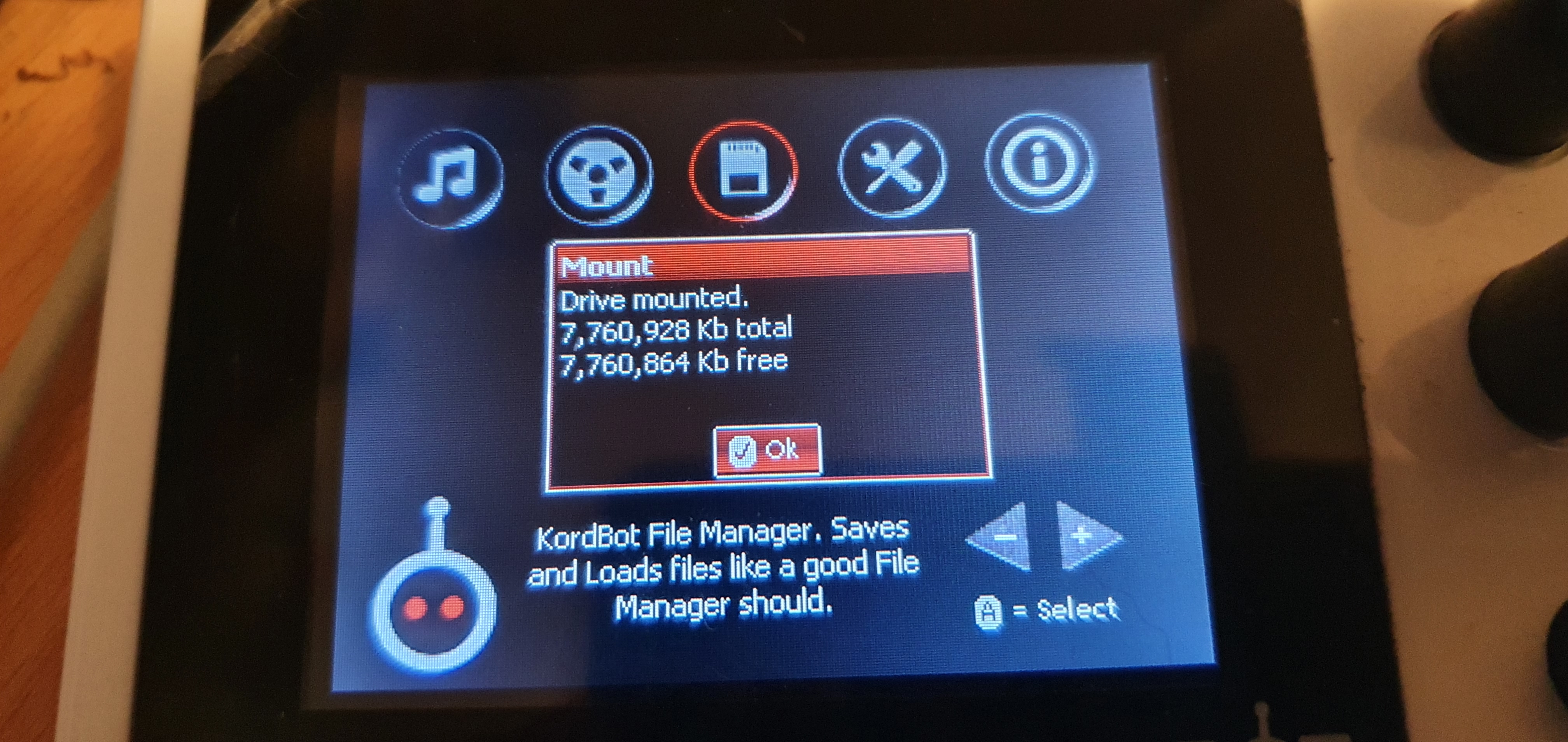

Tried it on a second pc and it seems that it’s not doing the partial erase job you showed in your video and rushes through writing blocks. It says Programming complete but nothing happens on startup.
Hi mate, fails to do that.. it mounts fine and its the same card I used since I got the kordbot. Very odd!
its also the came card i did the update with :slight_smile:
ive also just tried another card and i have the same problem

Changed my SD card from a 4GB Transcend to a 32GB Sandisk and everything went just fine. I succeeded in updating to V6.
Worked for me on Mac, running latest version of Mojave. Used an old Sandisk 1GB SD card that must have come from an old camera and it worked fine.
