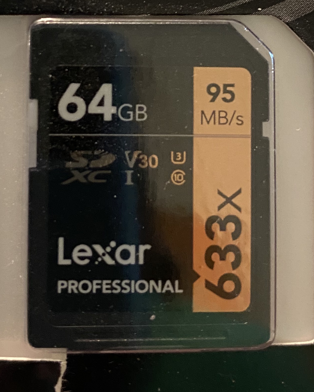

just an exact itemised list please. yes it makes sense now after 6 hours of thinking ive done something wrong as nowhere was i told before i started the process not to attempt this procedure without an sd card…ive never used one. im not a stupid guy i build pc systems.
so now i have to wait for Amazon…then if i go by whats being said here…i was stupid to just order the first one on the list , a skandisk 64gb as im worried that i may have to buy several smaller ones.
a or i could be a whole week before it luckily works and several amazon deliveries
