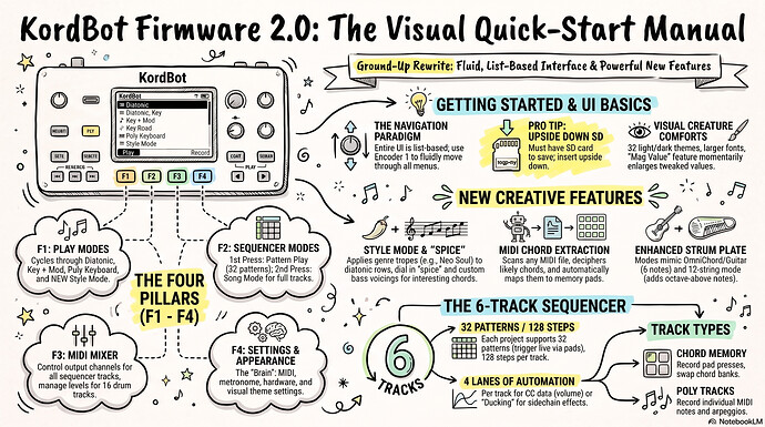

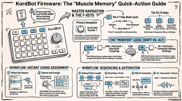

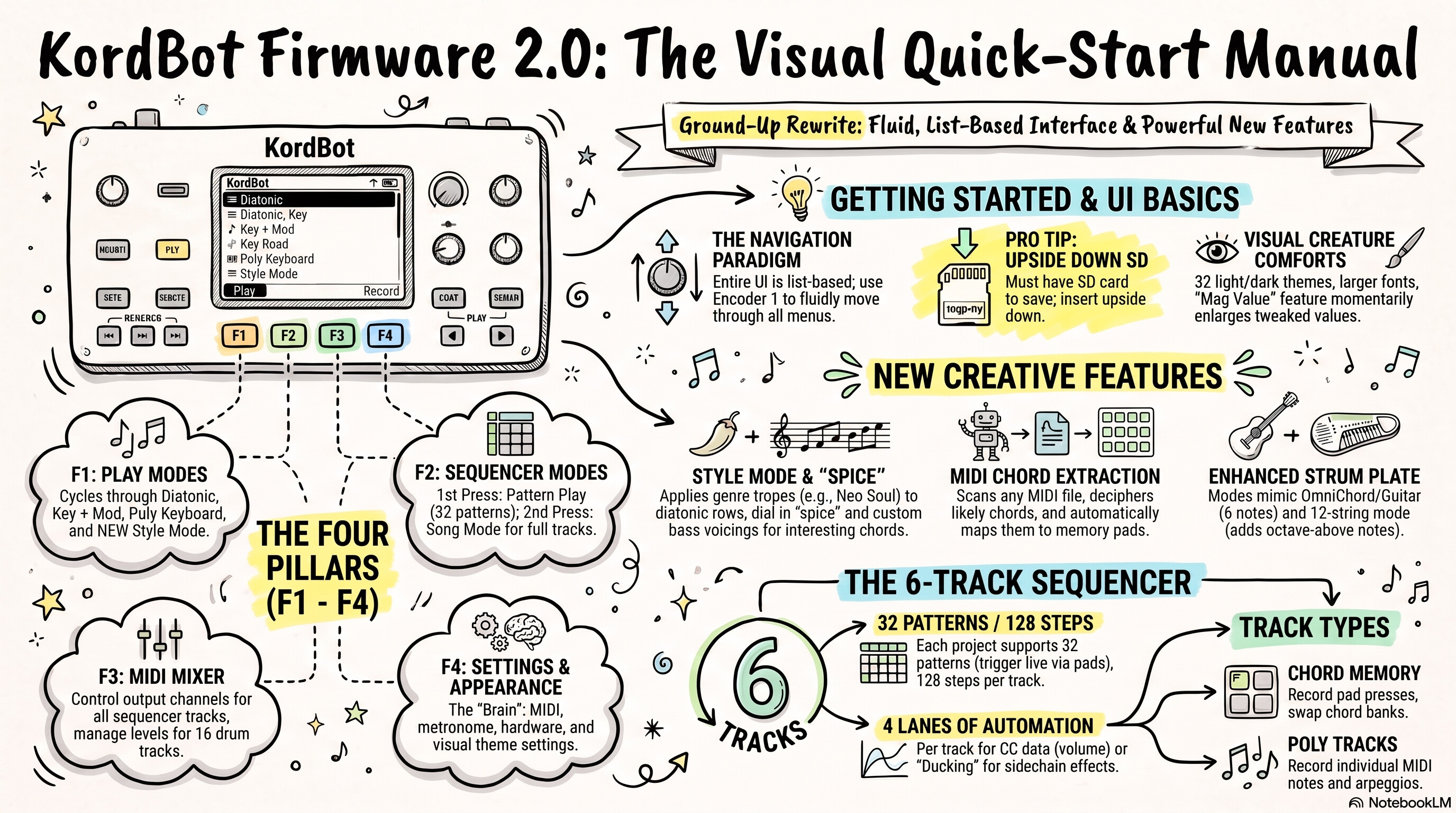

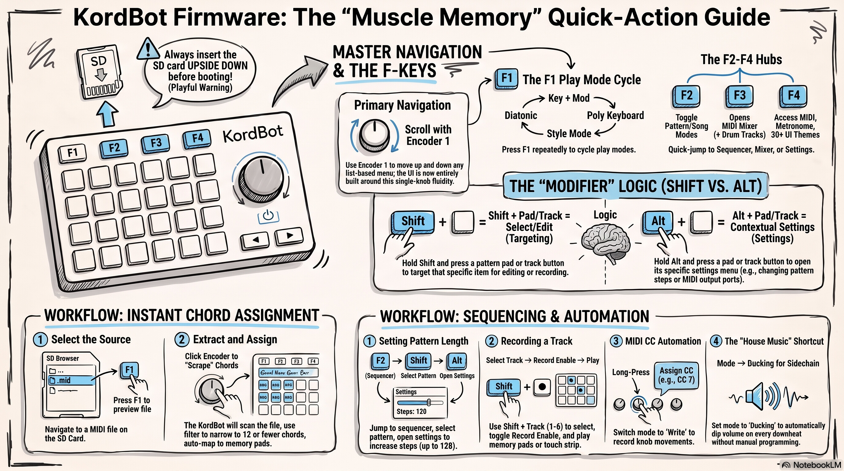

I had Google NotebookLM generate these two visual guides for my own reference based on Brad’s video walkthrough. I believe they are accurate to what was shown the video. Maybe helpful to someone else too. Hoping for a manual soon!
Good work there, nicely done.
