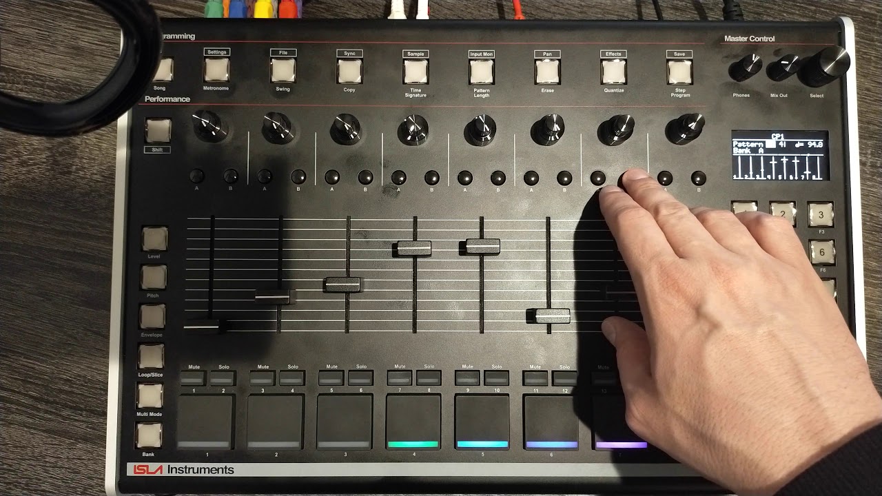

By the way, I used the boost in mixer mode in the following video. My main sample has envelope, filter..etc applied and I override/ un-override it. To be able to compensate the lost of level due to the filter setting I applied a boost of 20db or something like this for track 7.
