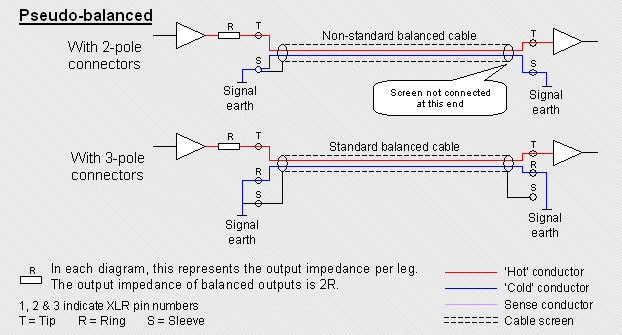

This doest sound like a normal thing to me. I wish I knew what " psuedo" balanced actually is too. Maybe this is a firmware fixable thing ? I really want to use the individual outs to an analog board but dont want elevated noise floor in the process.

Pseudo balanced (TRS) outputs just one phase of the signal and the other is grounded. Unlike Balanced which outputs 2 signals that are 180 degrees out of phase of each others. This is how I understood it

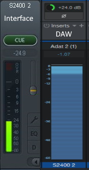

I loaded a 0dB 1Khz tone on all pads A1-A8. I have played them with all levels (faders up) maxed out. Using my RME interface input meter, the level registers at about -24dB. So within my Daw, I max out the trim to +24dB. I’m sure this can be recreated on the test bench
That sounds about right to me to be honest. They’re not balanced outputs, so it won’t come in that hot. If the receiving equipment is set up to operate at +4dBu then the S2400 pseudo balanced outputs will need some boosting I think. I have the same thing with several pieces of equipment that have unbalanced outs.
Edited to say that bear in mind 0dbFS in the DAW is usually something like +18-24dBu, so you wouldn’t want any individual channels average anything close to that level anyway.
Balanced is -+4dB and Unbalanced is -10dB. So since the S2400 is basically Unbalanced, the levels should not need a +24dB boost, or am I incorrect? I have several unbalanced outboard gear connected to my interface’s balanced inputs and the levels are still not that low. I think a level check in the lab needs to be done to confirm
They’re all different things though, it’s very confusing. It’s +4dbu, -10dbv (not dbu) and then once you’re in the DAW it’s dbfs. 0dbfs in the DAW is usually at least +18dbu in analog world - it basically represents the level at which clipping starts in the digital realm.

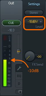

I plugged one of the S2400 outputs into my audio interface’s switchable input, which can accept +4 or -10. I set it to unbalanced input which gives it a gain boost. As you can see, the 0dB 1Khz tone registers at -10dB. Something just ain’t right with the levels. Anyone else experiencing the same? Or maybe it’s just me

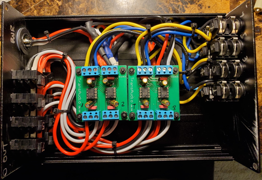

I built an 8-channel Unbalanced (TS) to Balanced (TRS) converter. This boosts the outputs a bit more. Still added a +4dB gain to the inputs on my audio device:
Wow, thats a beastly build youve done there…Where the TransAudio boards off the shelf or something you did custom?
