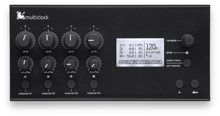

what is your multiclocki?
and what i/o does it have?
It is this one
I tried the Multiclock also in Internal Mode and i also tried a different Sequencer (Beatstep Pro) to see if the problem comes from the Multiclock but the problem remains and i talked to another Sp2400 owner and he has the same issue. It just jitters 0.2 bpm somehow.
