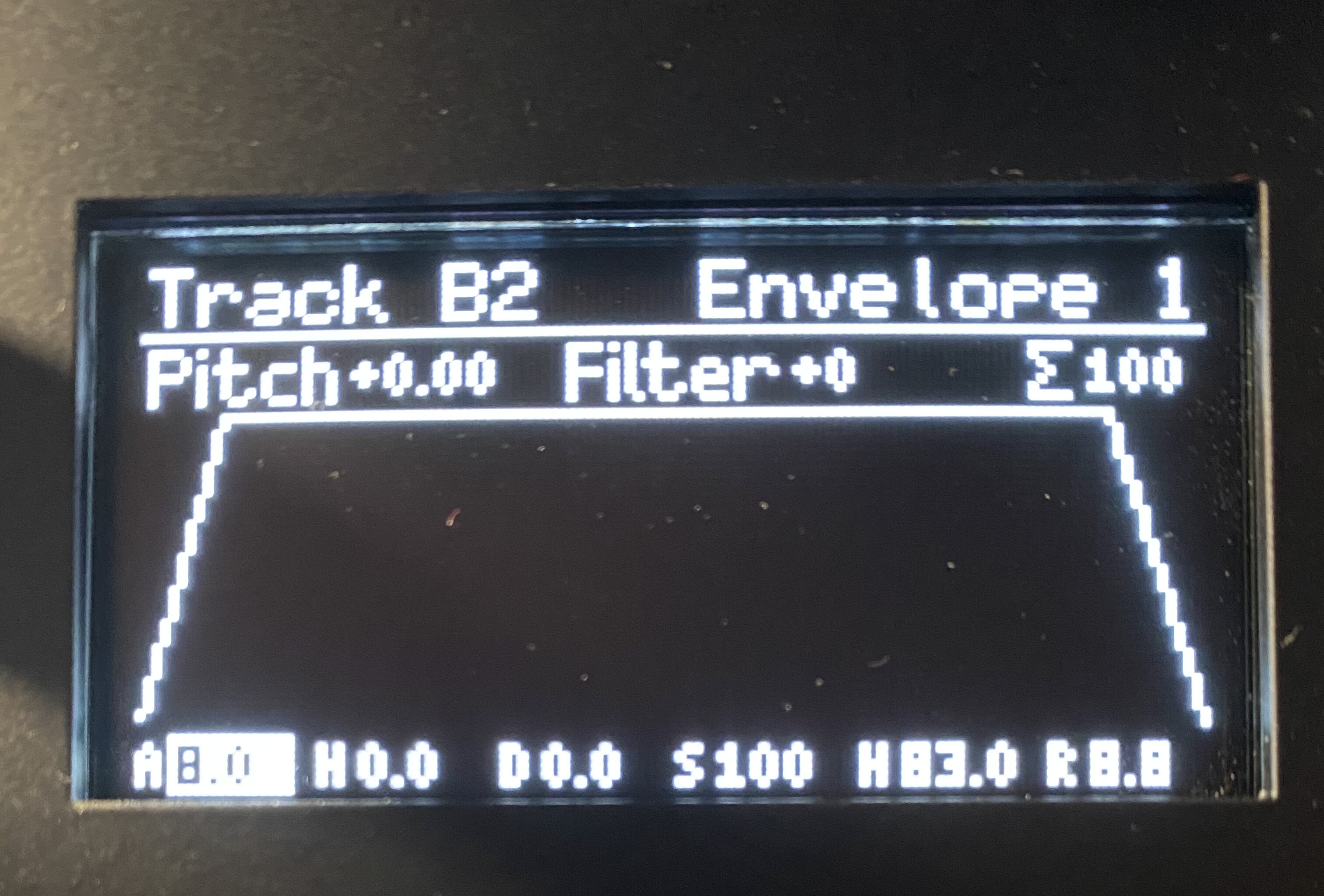

Ive noticed something that I cant seem to workaround and it feels like an envelope bug to me. Say I take a few longish samples and assign them on pads 1-4. In the Track settings I assign them all to Channel and subchannel 1 so they are all in the same choke group. When I tap pad 1 and then pad 2(or 3 or 4) afterwards there is a pop/click(sounds like DC offset or the sample isnt at the 0 point). Initially, I thought, no problem, I will just set the envelopes to soften the attack and release which should allow the samples to ramp up in volume a few milliseconds to allow for the click to be inaudible.
This does not work even at extreme envelope settings. However, this does work for tapping 1 pad repeatedly. Meaning if I tap A1 a bunch of times in a row the attack envelope smooths out any clicks and pops, but if I tap A1 and then tap A2(choking A1 and bringing in A2) there is sometimes(50-75% of the time) pops and clicks on the transitions.

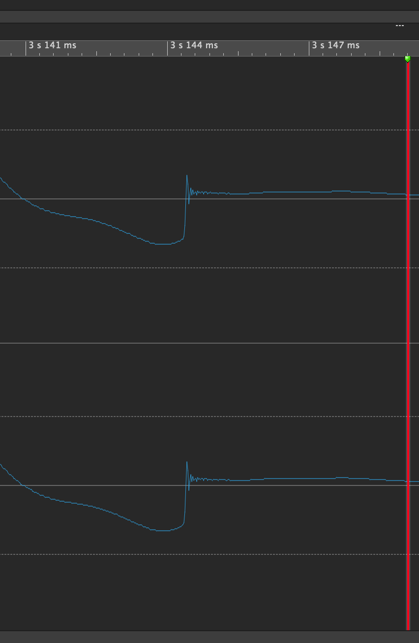

I did a quick recording to demonstrate the noise Im seeing.. here is what the transition looks like:
