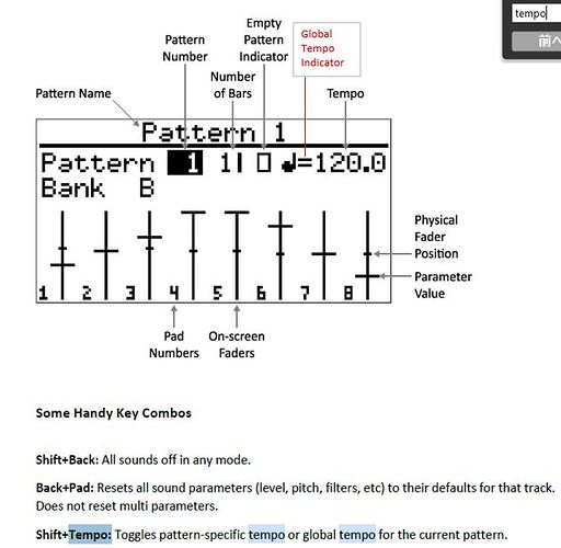

Next time the manual is edited, it would be nice if you could add an arrow pointing the “global tempo indicator”. Until now I’ve only used machines with the opposite behavior (no global setting, only pattern specific) and it took me a couple of minutes to understand the difference between the tempo icon with 2 horizontal bars and the one with 3 bars.
Just a very small detail but it could help other users who read the manual.
@tnkz76 Definitely.
That Global tempo Indicator has had me puzzled ever since I received my unit. I only figured it out yesterday when I was implementing an individual pattern tempo.

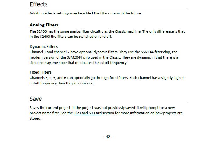

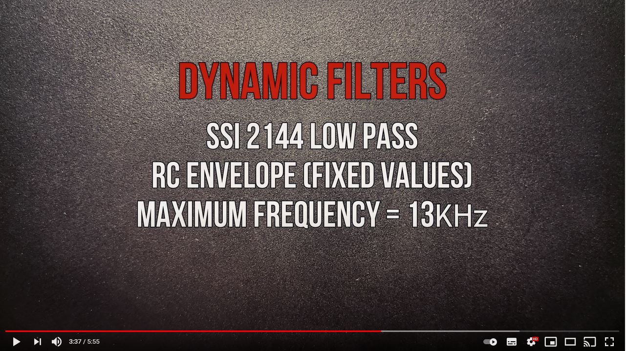

A suggestion about effects on page 42.
I suppose not everyone knows how the analog filter circuitry works in the Classic machine.
So for example in the “Dynamic Filters” section adding that it is a low pass filter with a maximum frequency of 13khz
In the fixed filters that it is low pass filters as well.
And adding a note about the fact that by design it can’t be heard via the headphones output (if I’m not mistaken) could help too.
@tnkz76 Thanks. We will add that.

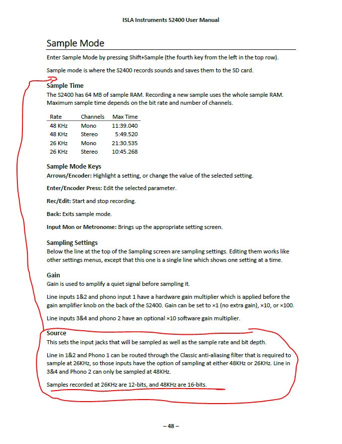

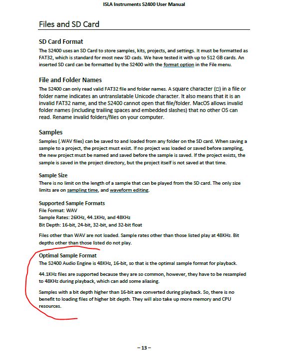

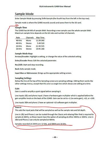

Another suggestion to remove something that is (a big?) source of confusion on the Internet:
Modifying the following data may help:
-on page 13 in “Optimal sample format” adding a note saying that sampling is done at 16 or 12 bit and adding a link towards sample mode (p48)
-on page 48 bringing the “Source” paragraph on top. In my opinion it is the most important information on this page.
-on the website rewriting the Sampler / audio paragraph. I suppose this would be Brad’s decision and I suppose this is the main source of confusion. I think making things clear is good for the next buyers/ users. :slight_smile:

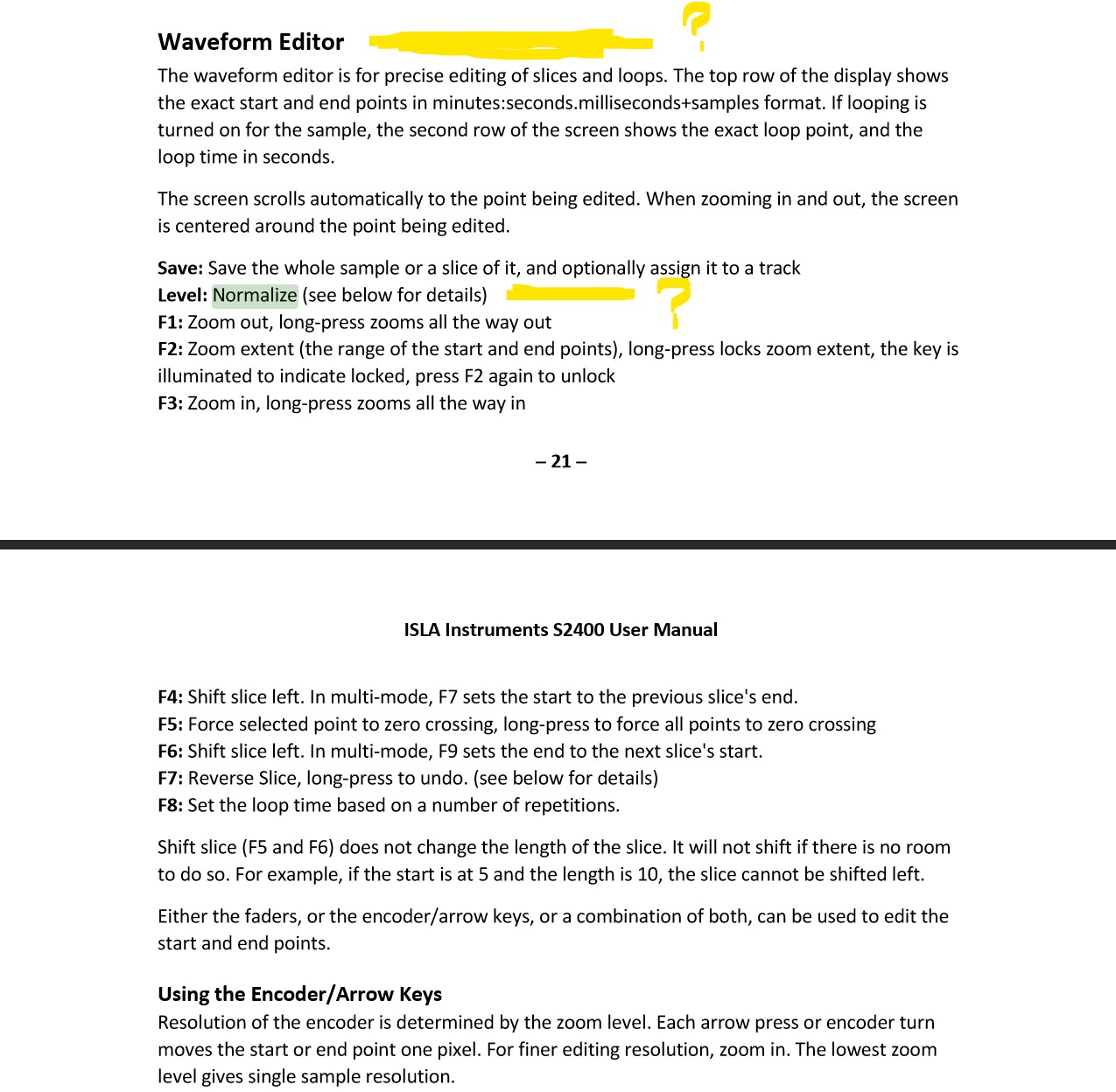

I’ve got a suggestion too:

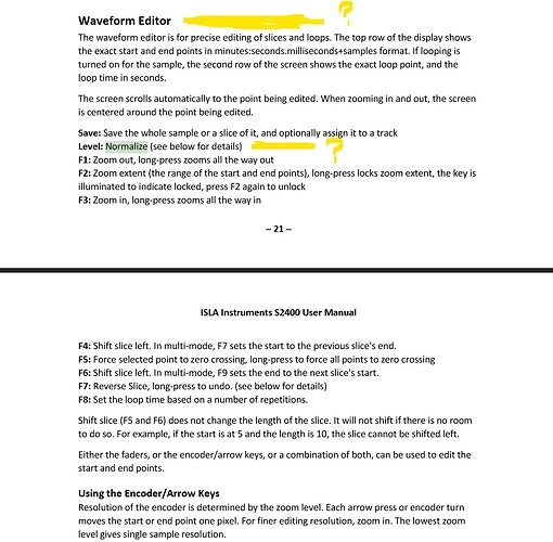

I seem to find myself reading about all the functions, but most of the time when I get to any given section, it tells me what the function does but is lacking the key commands to make it happen. “Waveform editor” and “Normalize” here for example. It’s not clear how to get to the waveform nor how to normalize the sample once you’re there.
If these were listed just to the right of all the various the functions, maybe in a dark gray vs black, it would be hugely helpful :slight_smile:
