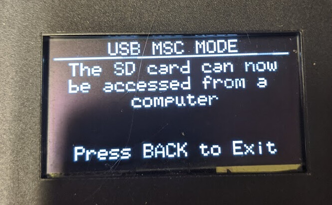

To have your computer recognize the S2400 SD card as an external drive, you have to put the S2400 into MSC (mass storage class) mode. The option is on the File menu.

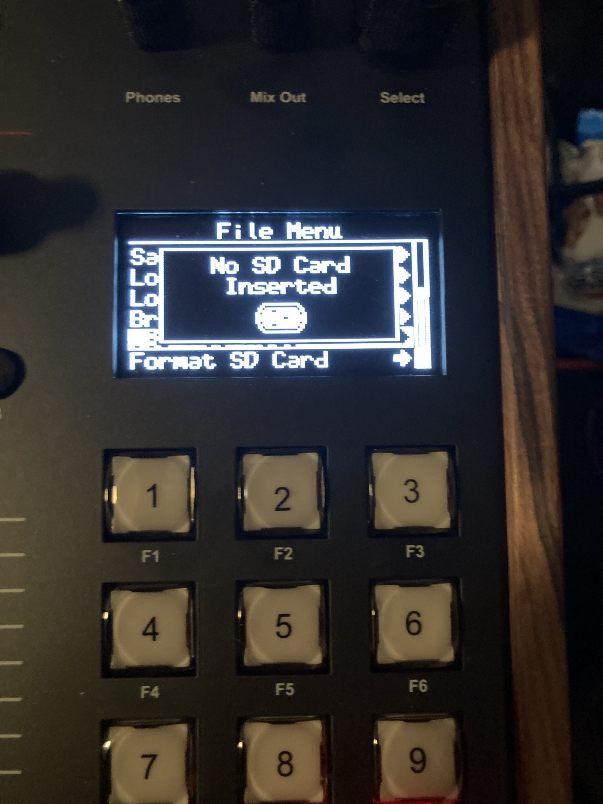

My mac or pc will not read my SD card. I tried MSC mode multiple times and it continues to state " SD Card Not Inserted". Different cards was used as well as wires.

when you go to FILE → USB MSC MODE, a screen appears that says “USB MSC MODE … press back to Exit”
while in this screen (DO NOT PRESS BACK), what does your PC or MAC do, does it report a USB mass storage device?

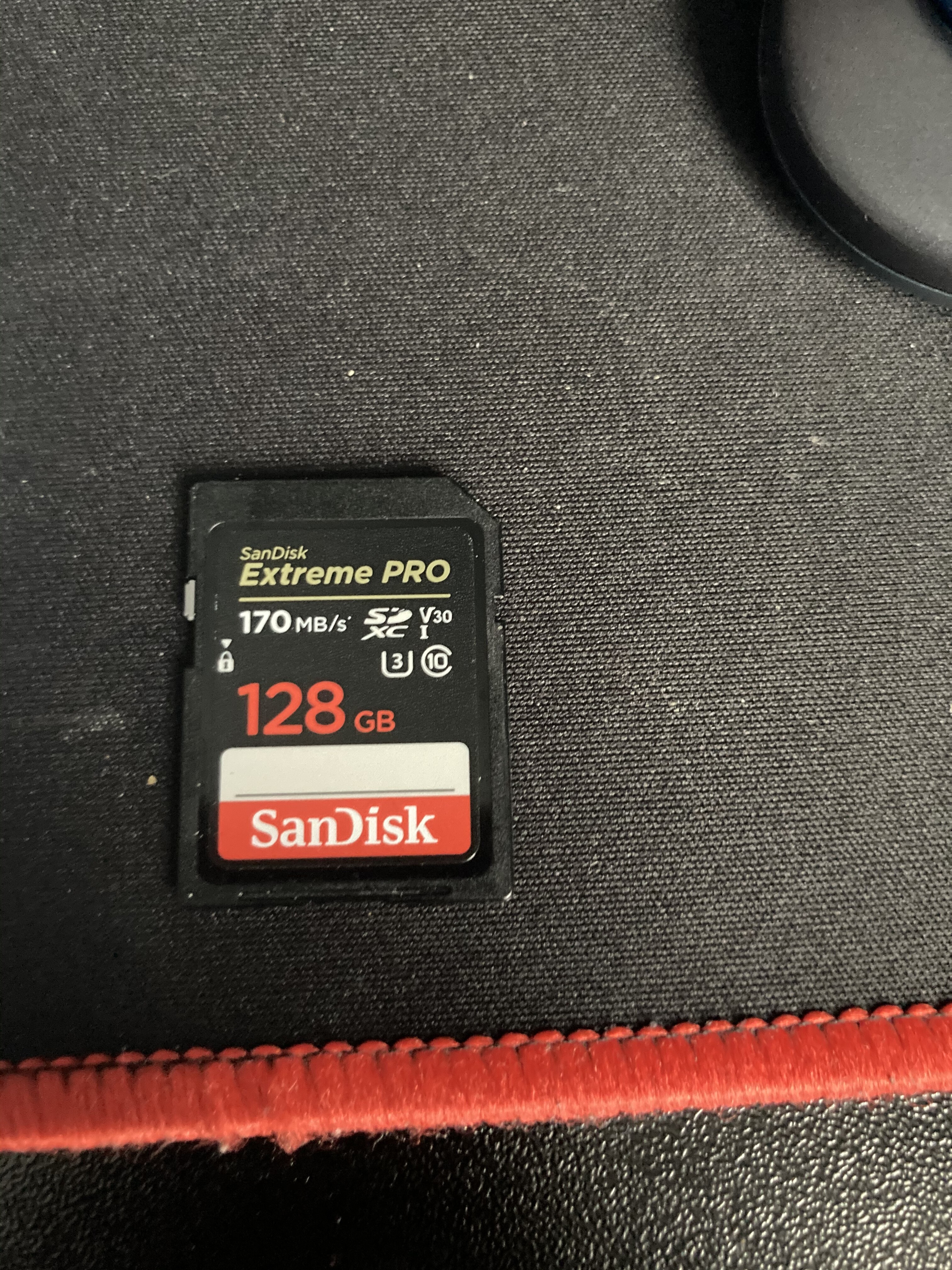

The only way transfer my files is by using my computer. Im currently using Sandisk Pro 128. I tried 5 other brands but no luck.

ok, lets back up a second.
  1. go to FILE
  2. select USB MSC MODE
  3. press the encoder
do you then see this screen???
this IS USB MSC MODE, do NOT press BACK.
now, you see the above screen, the S2400 should appear as a USB drive on your PC/MAC

It shows “No SD Card Inserted” when I press the encoder for MSC Mode. My windows and Mac do not appear as a midi device neither.

ok, one more question: when you unplug the USB cable on the back, and you go to MSC MODE, do you also not see the screen that I posted?
It says " No SD Card Inserted"
OK, one more thing. on my machine, when I remove the SD card and I try to go to USB MSC MODE I get the “no SD card” screen that you posted. but not with a card inside.
