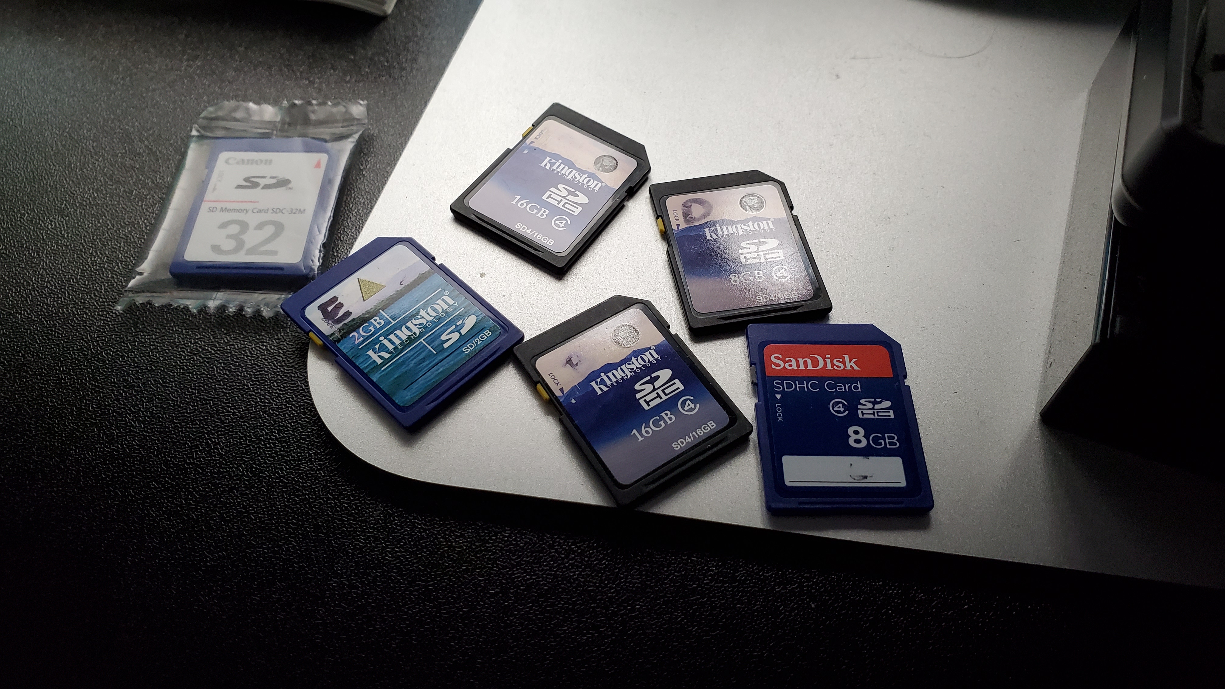

What speed are the SD cards you’ve been testing with? I’m seeing some great deals on 100MBS cards on Amazon right now.
this is a great question, only Brad could answer but i imagine the faster the better
also i see he has tested all the way to a 1tb card WTF
Well speed and size are two different things
there’s no need for an ultra fast card as you would need for your HD camera, any recent card will do
Interesting. I figured it’d need to be decently fast to read samples in realtime. Thanks for the info!
Audio is a lot less data than video. At 16-bit/44KHz audio is only 5MB per minute (10MB/min for stereo).
Wow! I guess that makes sense though considering those old DR202 samplers had super slow 4MB cards.
I have been testing with two cards, one is relatively slow at 30mbs and has not been problematic. The other is a 100mbs and that one has been fine also
The main problem is speed of copying a lot (gigs) of samples over to the SD card, this is something you wouldn’t want to do over the built in USB as it seems to be USB 2.0/Hi Speed capped at 480 Mbps (this only from me seeing the 2.0 B connector on the back of the s2400, I could be incorrect).
I would recommend going with an SDXC card that’s Class 3 (U3), it supports up to 2 TB and 30 MB/s (minimum speed) at that rating.

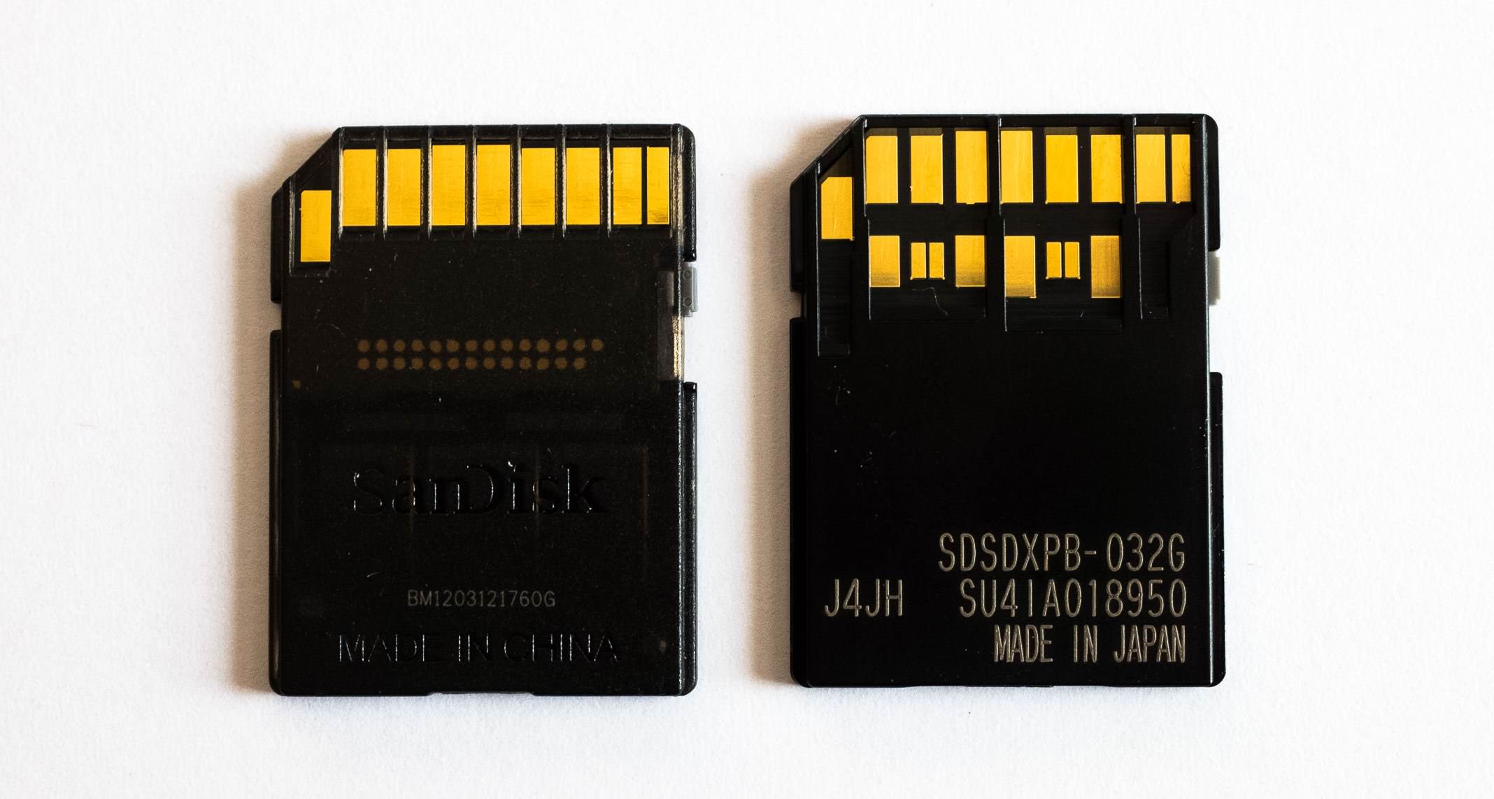

Has anyone tested any SDXC UHS-II series cards? I know its probably overkill, but I just want to make sure the S2400 is compatible with the UHS-II series cards before buying a couple of them.
hi and welcome djchino
as yet only the testers or brad can answer, they don’t show much here as they have their own forum right now for beta
tag @bradholland and let us see if he has got any more info on this, he did a video but i cannot point to the right one where he discussed cards sorry
I highly doubt it has the extra connectors needed for UHS-II, it should work but not at the highest speed. You would be paying for too much of an SD card, just go with a SDXC U3.
Appreciate all the replys! I’m now looking at a SanDisk 256GB Extreme PRO UHS-I U3 SDXC Memory Card.
That should give me plenty of storage and fast save/load times. I’ll upgrade to a UHS-II series SD card later down the road if they end up being compatible & are much faster.
