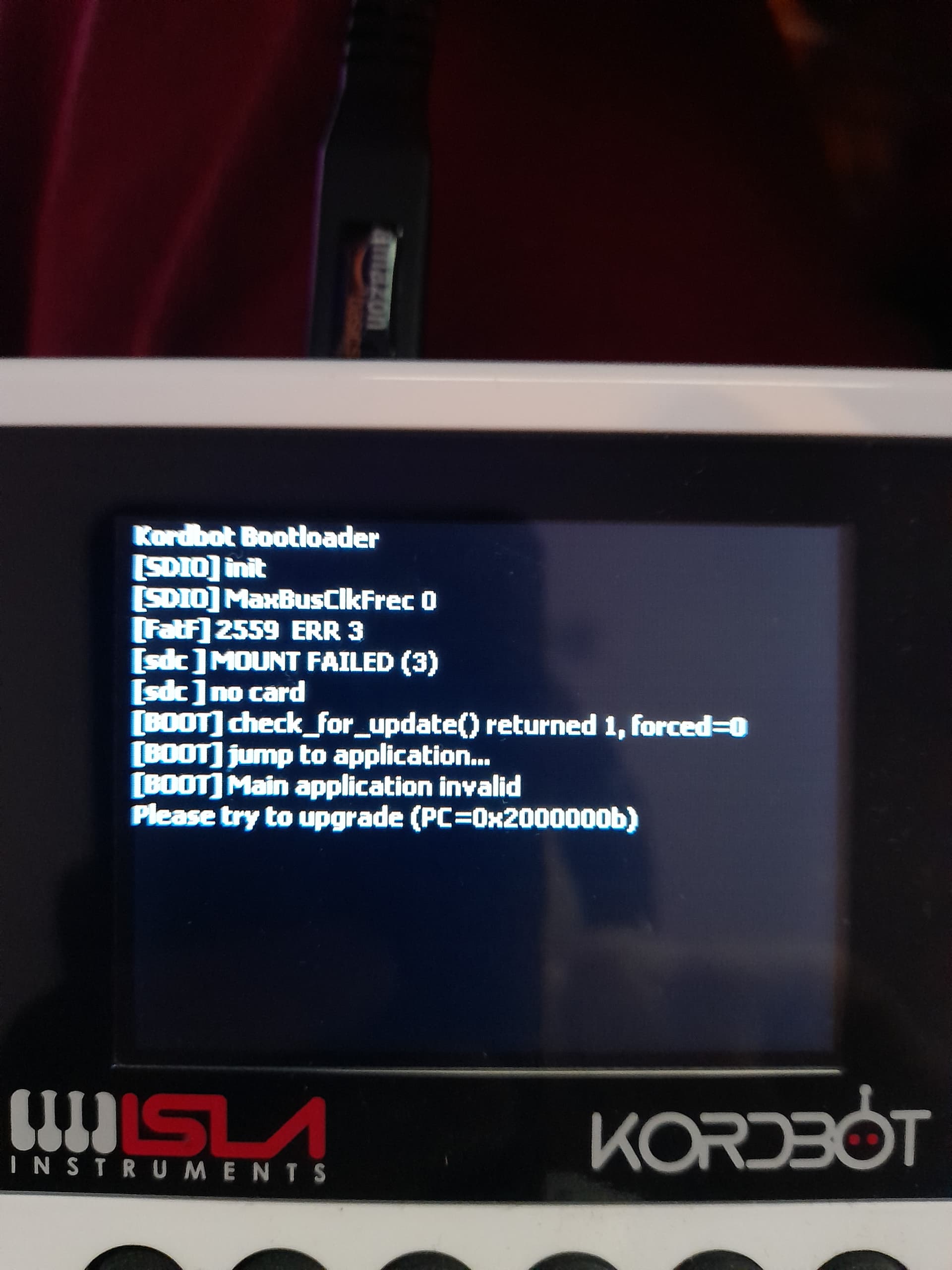

Have tried this, but when I ran the DFU KordBot application and tried to update the firmware, I got this screen. The firware application reports “programming complete” l but it’s now stuck on this screen and won’t even function outside of DFU mode. I’ve tried putting in an SD card, doesn’t make any difference.
Any ideas?
What steps of the FW update are you able to do correctly?
It looks like it doesn’t see your SD card , check that it’s formatted to fat32, it needs the card to update it’s required for step 2.

As Tom says, this is just the new bootloader awaiting the latest OS update. Follow his instructions and you should be good to go. :+1:
So I’ve done the above with the new firmware and I’m still getting the same screen. Could it be the SD card I’m using? I’m using a SanDisk 512 MB Memory Stick Pro Duo.

Are you getting that Mount Failed message even with the SD card in? If so, it could be the card. Maybe try a different one.
Just reread your post. This is likely the culprit. I assume you’re using an adapter of some kind. Get a proper SD card. It doesn’t have to be large capacity.
Thanks guys. Bought an ACTUAL SD card off Amazon and followed the steps and voila.
Many thanks! x
