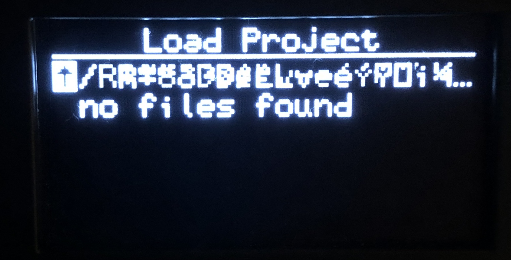

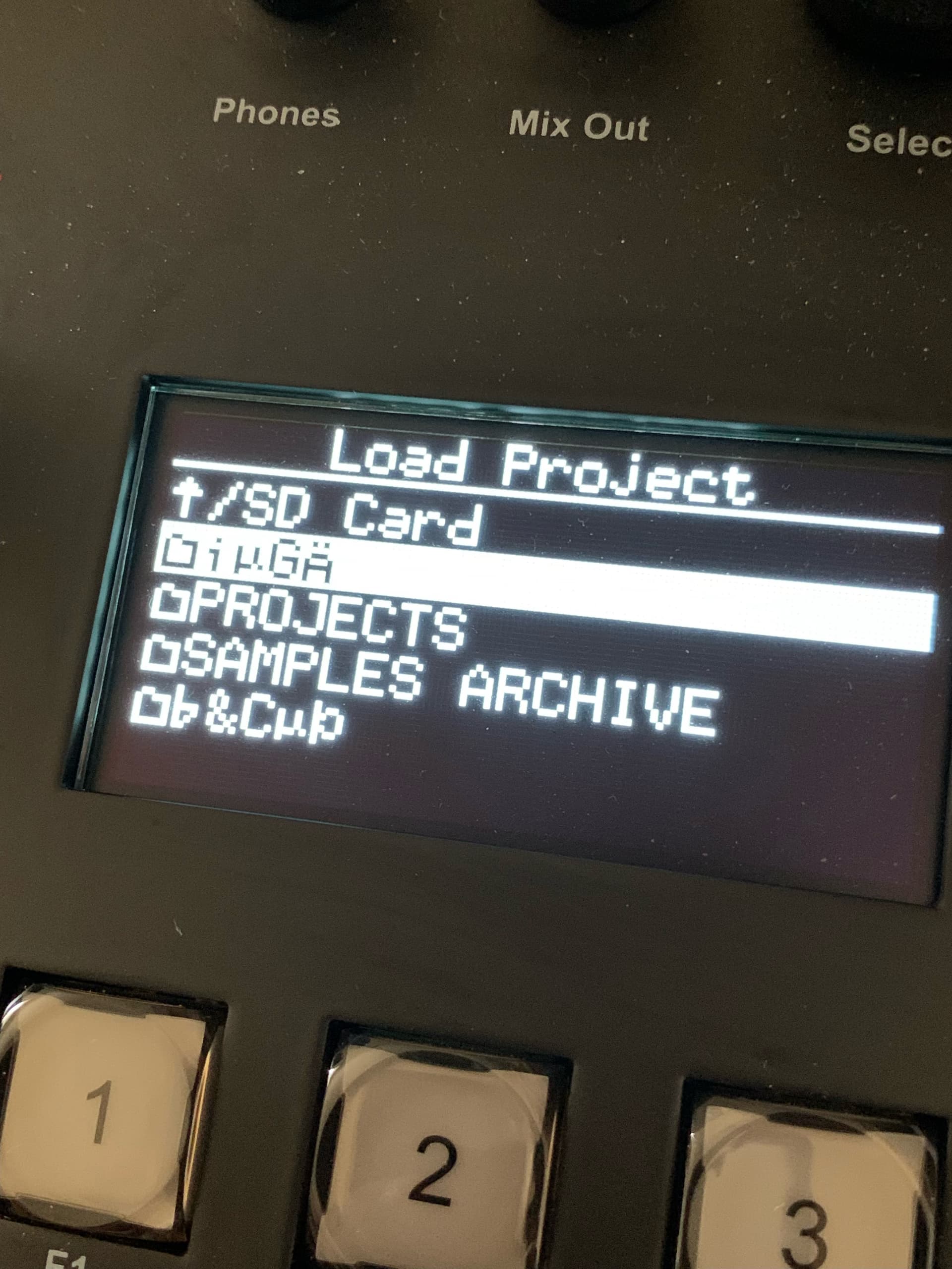

Description
Incorrect direcories are being created and navigated to when attempting to load a project or a kit from a freshly formatted SD Card on S2400.
Steps to reproduce

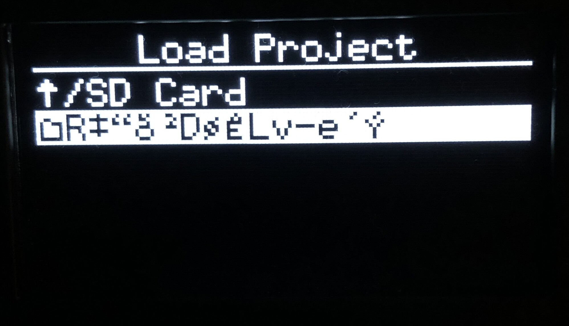

  1. Format SD Card on the device
  2. Go to File > Load Project
  3. Observe the result. You are inside a directory with a gibberish name. This directory is in root directory of SD Card.

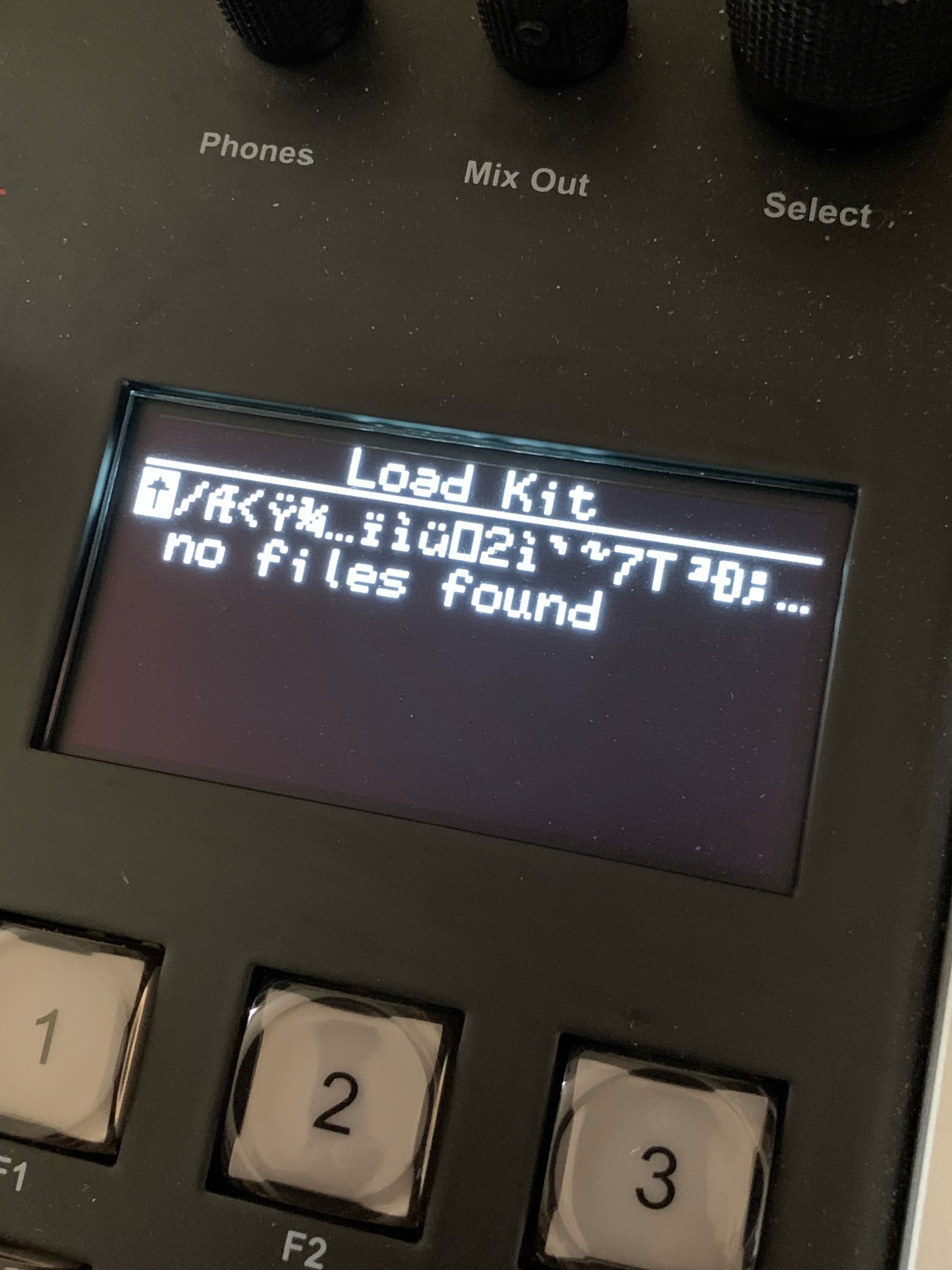

  4. Go to File > Load kit
  5. Observe the result. You are inside another directory with a gibberish name also in the root directory of SD Card.

ls -al output demonstrating “load project” case:
╰─ ls -al
total 68
drwxr-xr-x  3 cfd2       cfd2     32768 Dec 31  1969 .
drwxr-x---+ 3 root       root      4096 Aug 29 21:03 ..
drwxr-xr-x  2 cfd2       cfd2    232768 Jun  6  2015 R‡“ð²DøÊLv—e´Ý
I understand that projects are stored in PROJECTS/ directory and kits are stored in KITS/ neither of which currently exist on the SD Card due it having been formatted seconds before. So how do we end up in those weird dirs?
The generated name of created dir is always different.

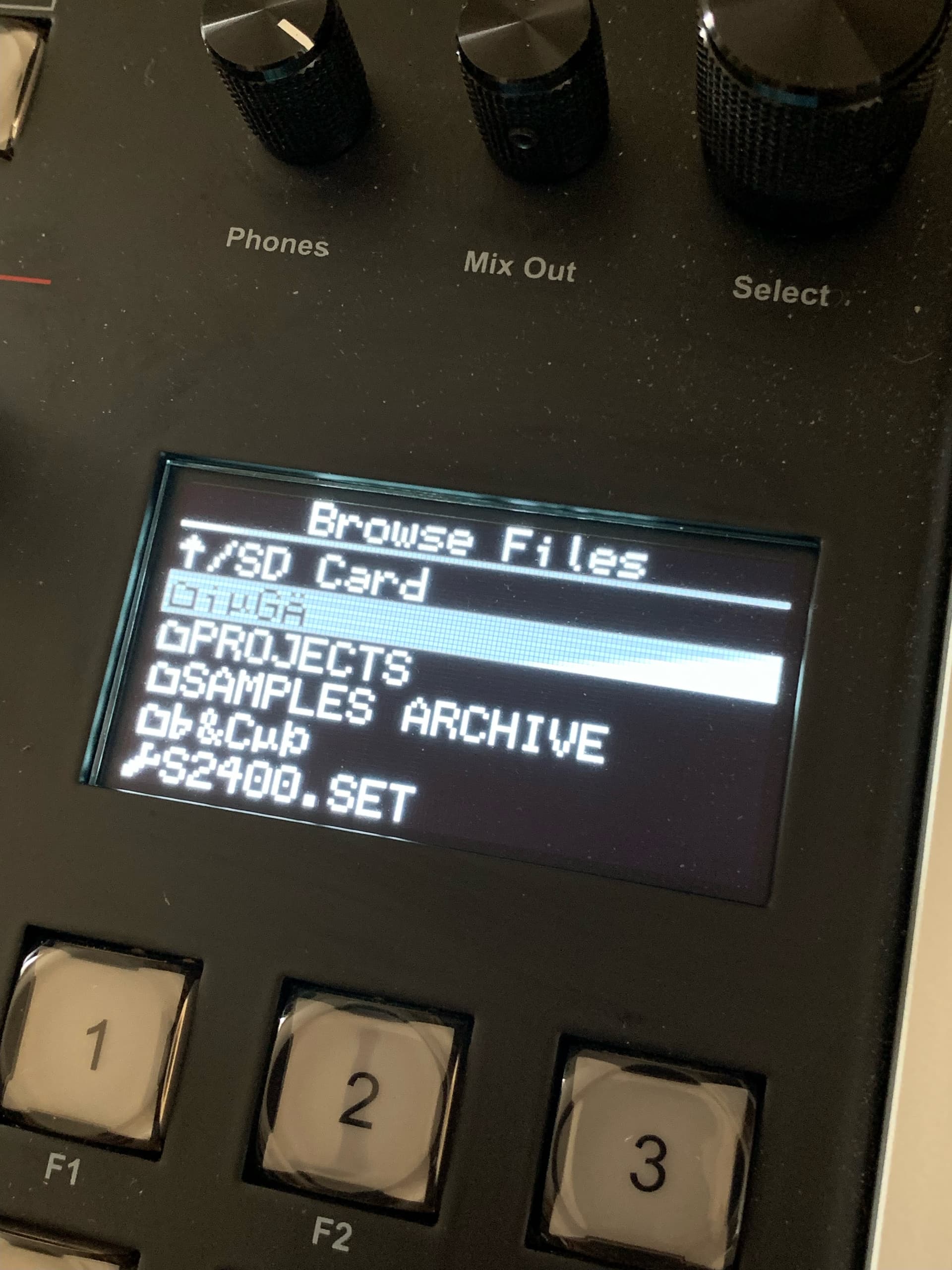

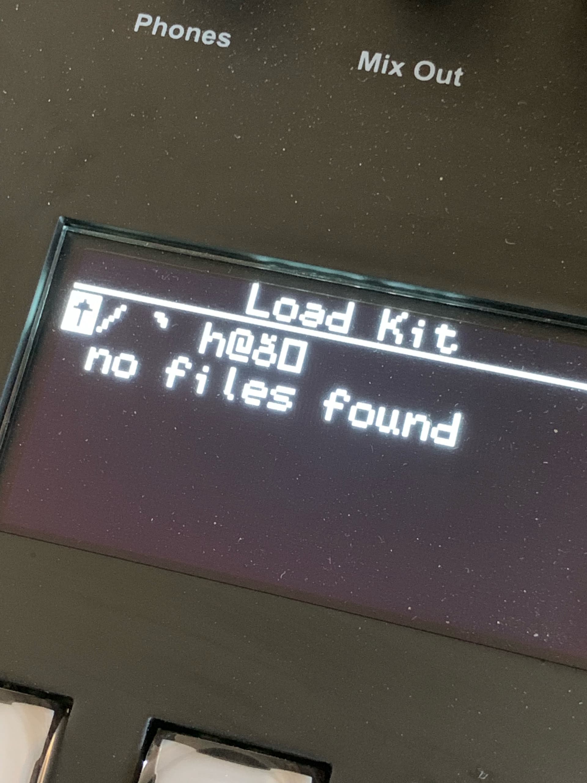

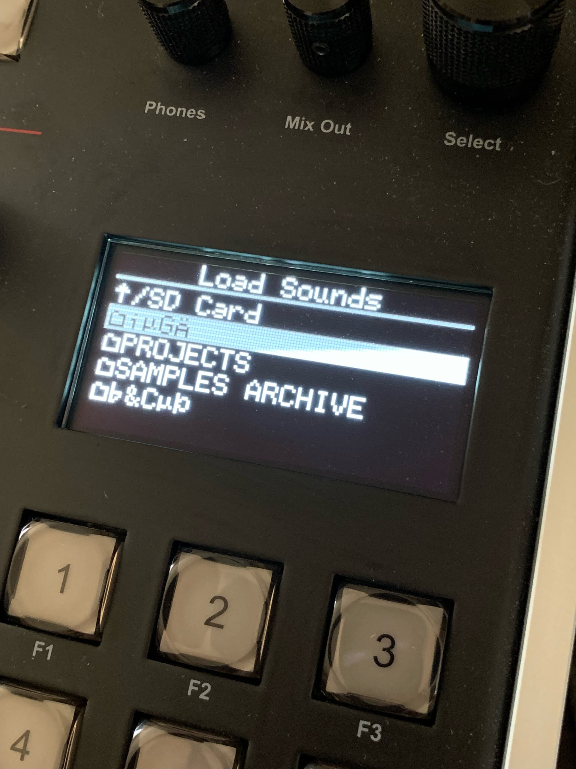

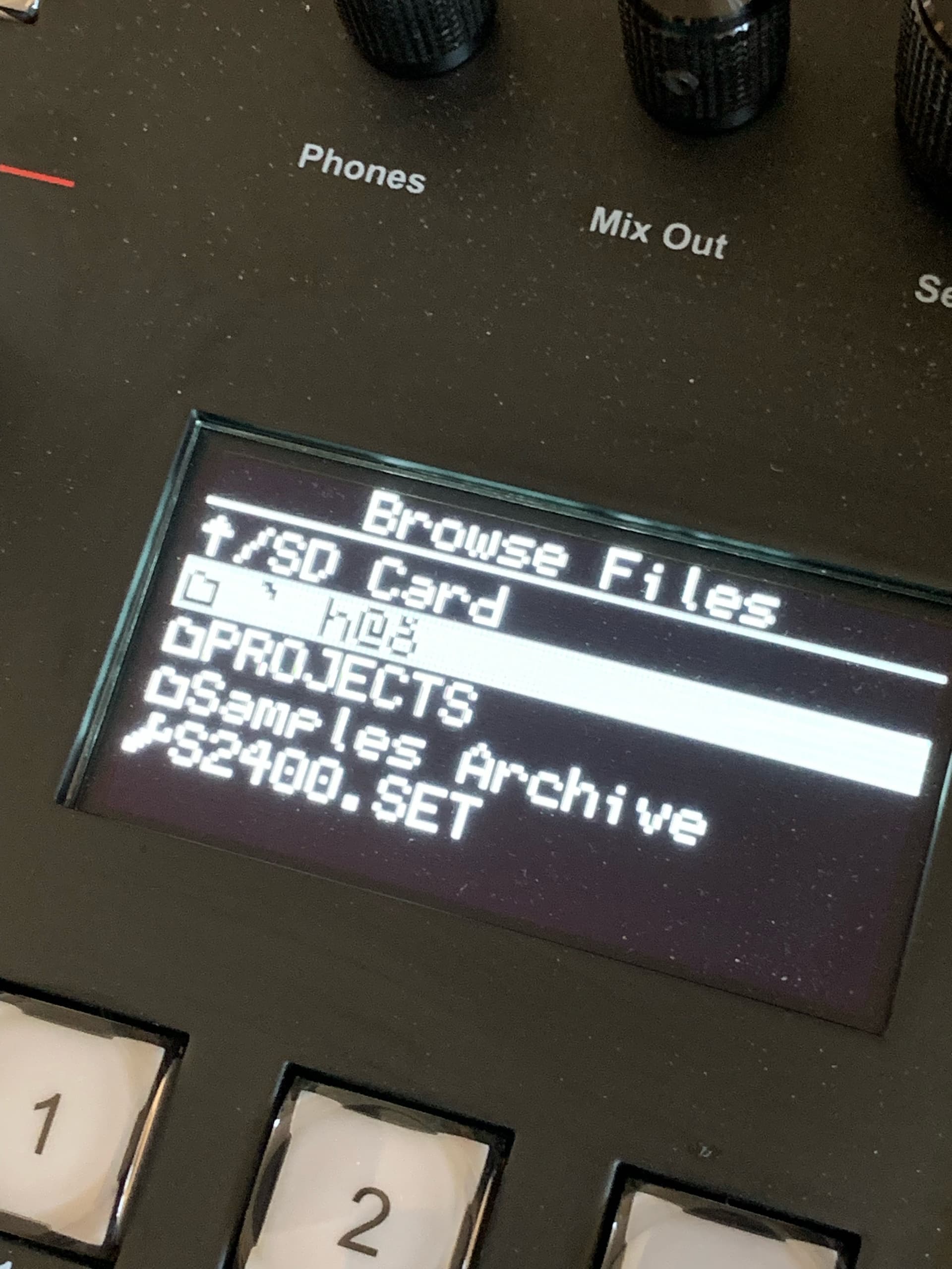

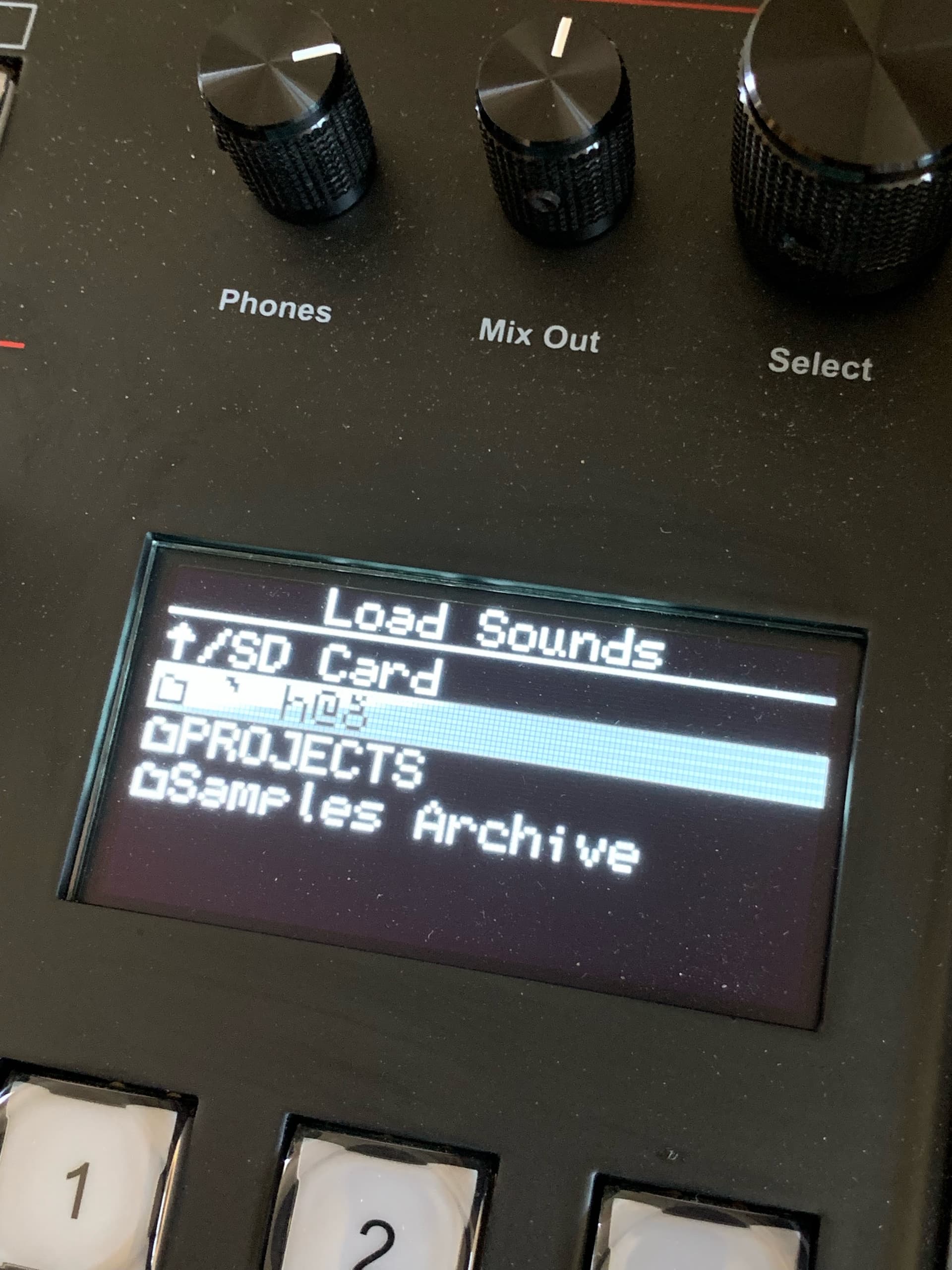

I get that 100% of the time, ever since the last FW and ever since my newly bought SD card (which I filled up all the way)… not in Load Projects tho… I get it after dumping a lot of sample-files into a brand new and newly formatted SD card, and trying to preview/load the sounds.

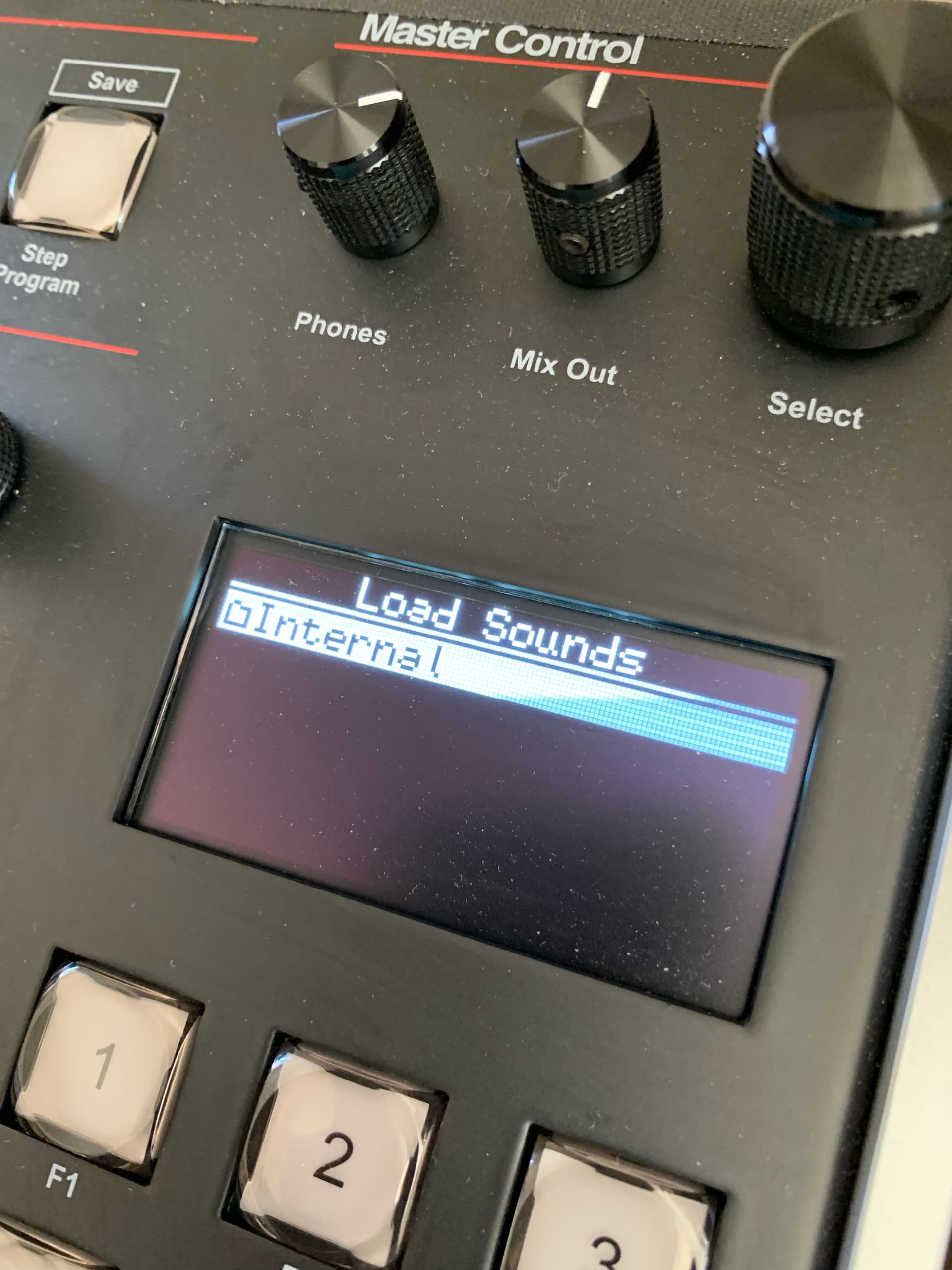

File Menu > Load Sounds Folder > SD Card > there’s a mystery empty jibberjabber folder made.

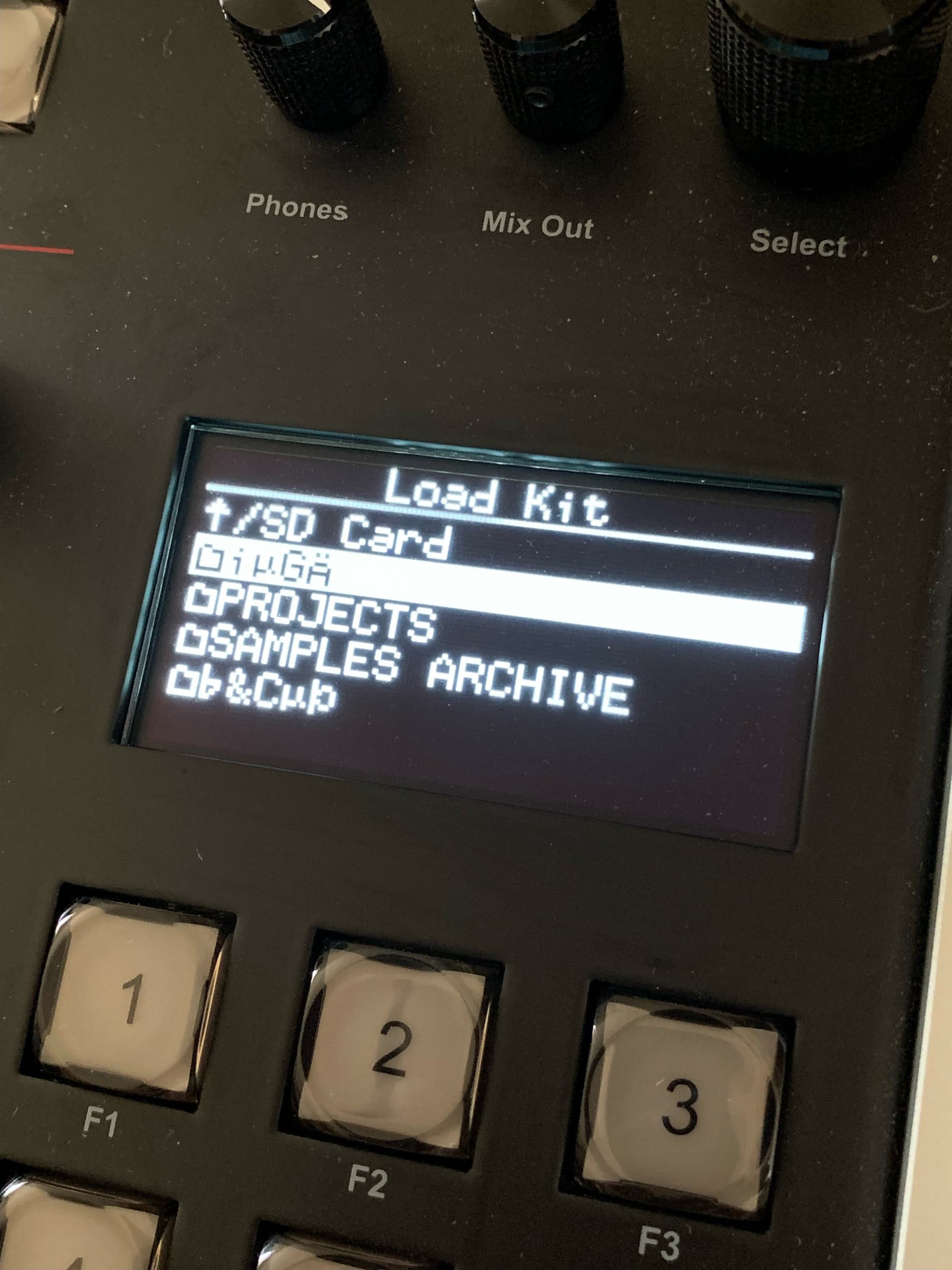

Also happens in:
  • Load Kit

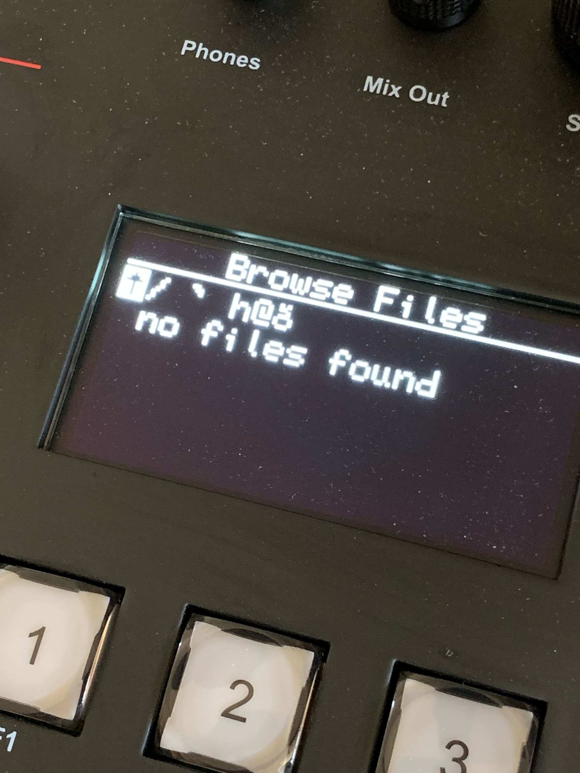

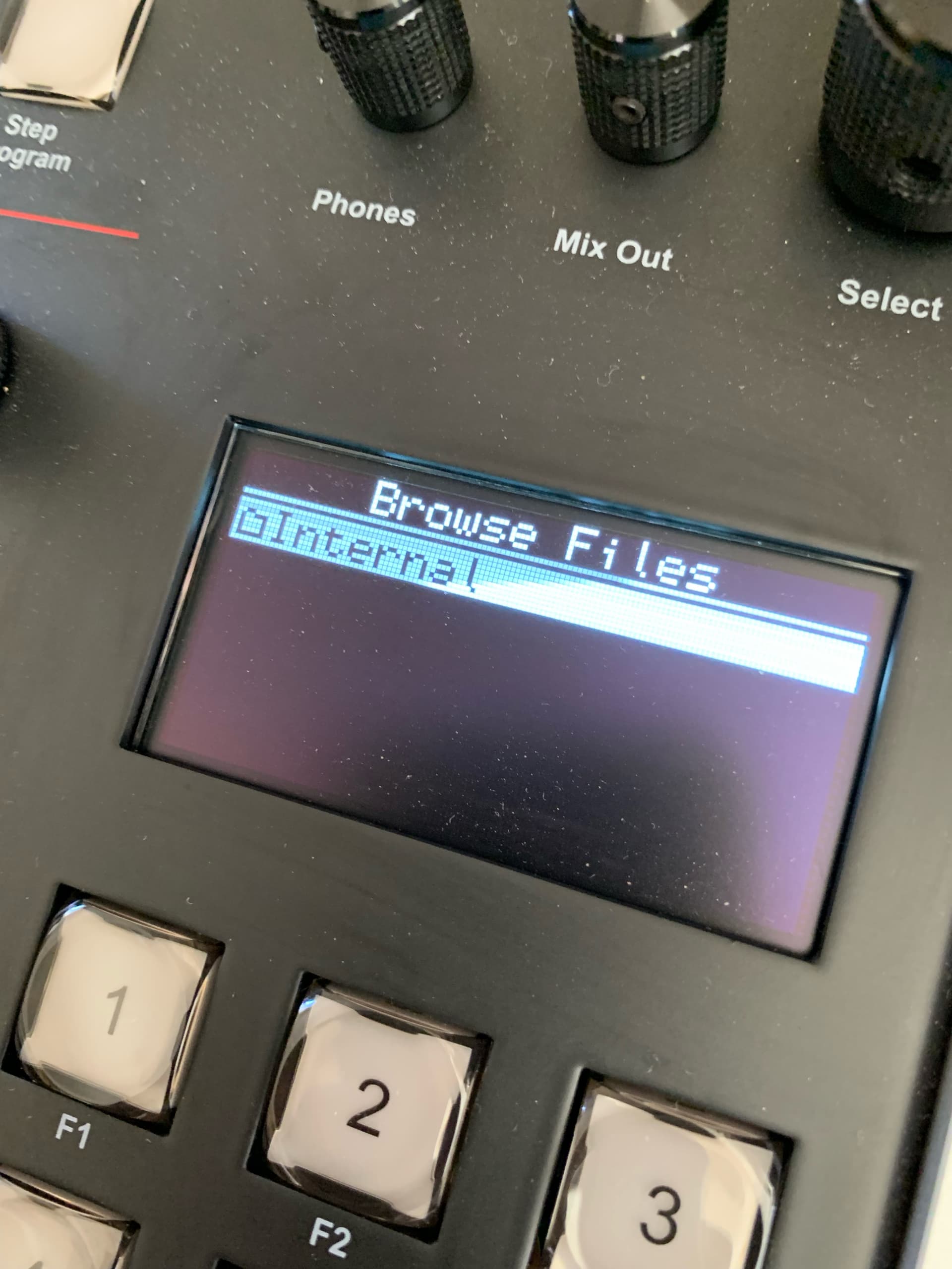

  • Browse Files (additionally, the other normal [Projects/Samples-Archive/S2400.SET] folders disappear after clicking on the jibberjabber-folder and then hitting Back [last pic])

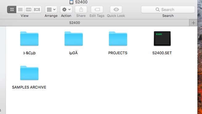

I have put back my project files and the unit still does the same thing like you said. It created two more directories — one when loading a project and another when loading a kit. This time I obviously have PROJECTS/ directory.
I have maybe 12 projects in total and they are fairly small. I don’t have many samples on my SD Card either (just a couple of well-known drum machines). There is nothing else on the SD Card, no hidden files, too.

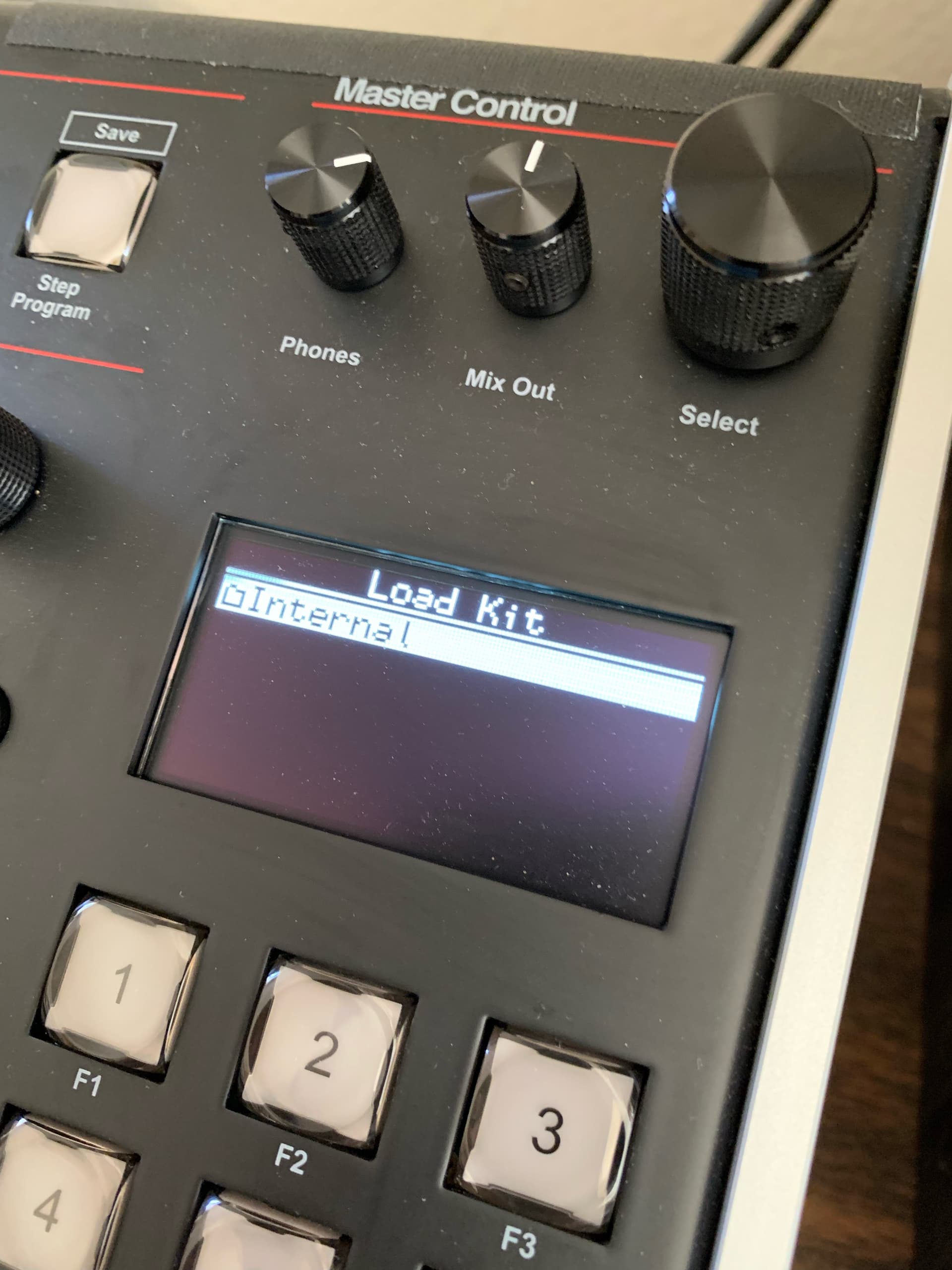

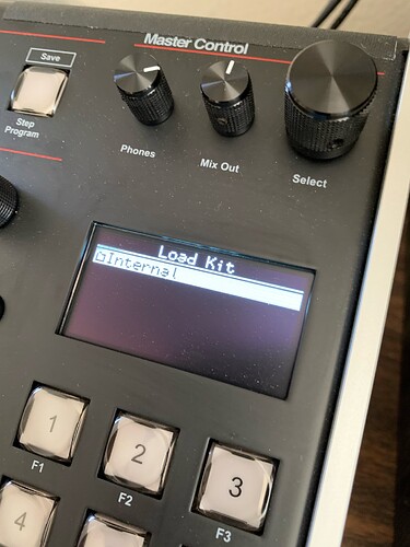

When I remove the SD card, the weird jibberjabber directories are now gone.
But… once I insert SD card again… those weird Predator jibberjabber directories return.
So… perhaps it’s got something to do with the SD card (too full and/or incompatible files in it?) or how the S2400 reads them?

I got a new Transcend 512gb SD card (previous one was a Sandisk 256gb, the cheaper gold one).
First, I only loaded it with 1 single folder of WAV files only, cuz I wanted to test it with only the correct compatible files and make sure the previous SD card with a bunch of random misc. files weren’t causing the prob. But, it still made those random folders with weird directory names.
The random folders with weird directory names look a bit different than the last SD card, and are also now in different areas of the menus. It now happens/shows in Load Project, Load Kit, Load Sounds Folder and Browse Files.
Prolly not a huge deal and you can easily just ignore them and work away. So I guess it’s just a problem aesthetically. Still looks buggy and messy tho.
I already tried reformatting SD and retrying +5x. Still same issue with randomly made folders w/ weird directory names.
