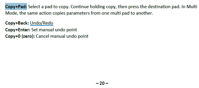

In fact, this feature has been added. There is an explanation about copy+pad in the manual.
The thing is that pad/track and events for this same track are separated.
So if you want the same events for the new track you still need to copy them.
Using separate functions in Copy mode, step pattern or organize tracks for example.
S2400_User_Manual_2021-12-24.pdf#page=37.pdf
